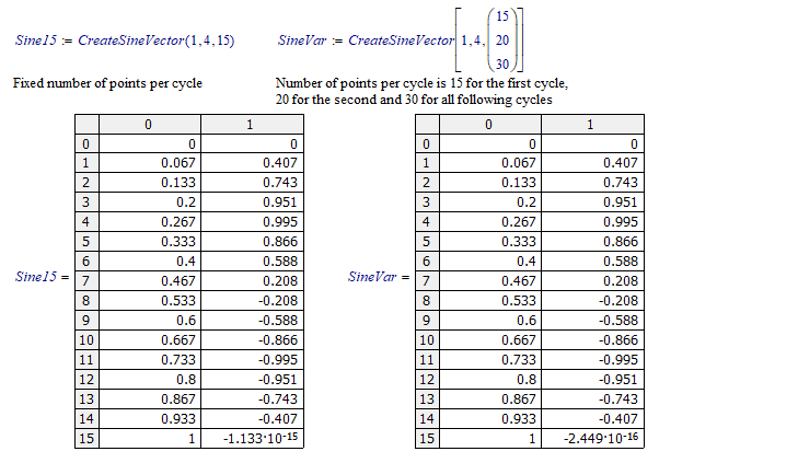

Here you see it called in both modes:
And the resulting plots are:
As you can see for the first cycle (15 points per cycle) the two point sets coincide.
For the second cycle there are more boxes than x-es, in the third and following cycles there are twice as many boxes as there are x-es.
