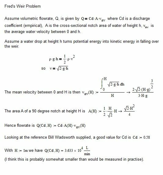

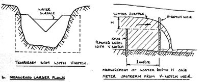

Okay, here's the challenge:  measure the flow rate of a stream.
  • Build a weir with a V-notch as shown below,
  • measure the water depth as shown.
What is the flow rate (liters/min) for a given height H?  A derivation and formula, please!
Best answer by AlanStevens
Here's my contribution

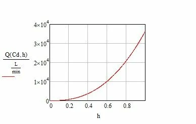

Thought I should add a graph:
Alan
Alan

This is an interesting illustration of engineering adapting physics.
Both Alan's solution (kudos, BTW) and the one attached below properly derive the physics of the problem from basic concepts: the gravity head creates a flow over the weir, and that times the area gives the flow rate.  But when the actual flow rate was measured it fell significantly short of what was calculated.
The old engineers, well used to having theory only approximate reality (because of the assumptions made to achieve a solution) merely created a "coefficient," to adjust theory to reality.  It would be interesting to see what ANSYS would do with this problem.
