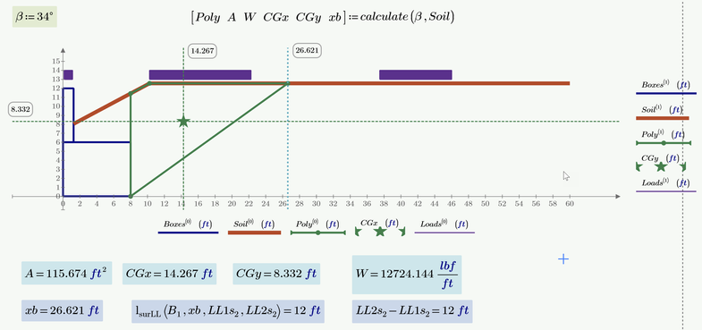

OK, based on the informations so far here is my attempt.
I provide a function "calculate" which, given the angle beta and the soil polygon as input returns area, center of gravity, weight and also the polygon so we can plot it. Its not completely self-contained as it relies on variables B1 and gamma to be defined in the worksheet.
Of course this function "calculate" can also be used to create a table of values. I have chosen 1120 steps because this will make for a nice step value of 0.05 degree but of course that value can be freely chosen.
Because Prime does not allow to change the units in a matrix with mixed units i decided to create a table with dimensionless values and add a header line which specifies the units.

Here is the modified worksheet.
I also added a way to create single vectors for all the desired quantities instead of a compact table as it seems that's what you actually are looking for.
You may have to check the logic in your function lsurLL because this function returns 0 feet for any value xb provided - at least when used with LL index 1 and 3. Or is this intentional?
Always check your functions by evaluating them using some test data!

I understand why only the second load can have any effect and so the others must result in zero.
I added violet boxes to represent the position of those loads and it can clearly be seen that load1 is to far to the left to be able to affect the wedges and load3 it too far to the right as beta is not lower than 34°. We would need an angle ß of 23° or lower to have xb exceed the 37,5 ft and so make load3 to have an effect.
The pic shows the situation with ß being the lowest value of interest (34°) and your function lsurLL correctly returns that the wedge is overlapped by load2 for its full length of 12 ft.
EDIT: I removed the point-in-polygon test area because that function is not used at all.
Also removed the calculation of 'weight' in the 'calculate' function as it easily can be calculated outside.
