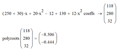

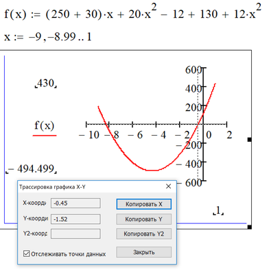

I would like to use all Mathcad tools for the solution this problem:
 The author of the last solution will get the gift from me!

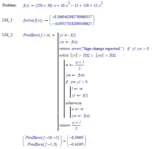

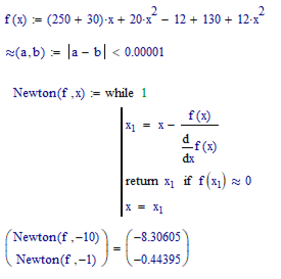

In real Mathcad (11):
My bisection
Newton

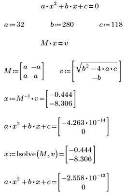

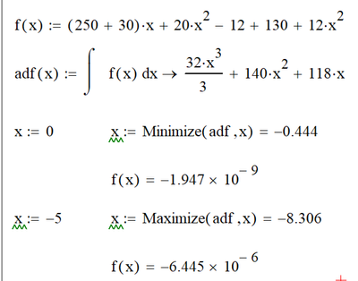

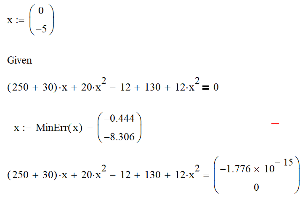

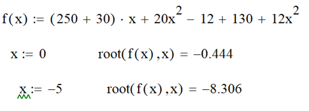

We have used Find, root, MinErr, polyroots, Minimize and Maximize functions!
We can use the lsolve function too! Why not! With Werner help!
