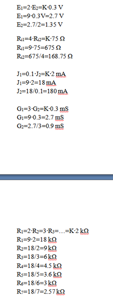

8bdf4fb1efac5f6dab5948e1f2ad937eI've been trying to figure out how to use mathcad since I didn't have any lectures about it in my university and I'm asigned a task that says to solve the equations by using mathcad. Could anyone help me out?
I've pasted 2 photos of variables that we know and equations from which we need to find I1,I2..etc

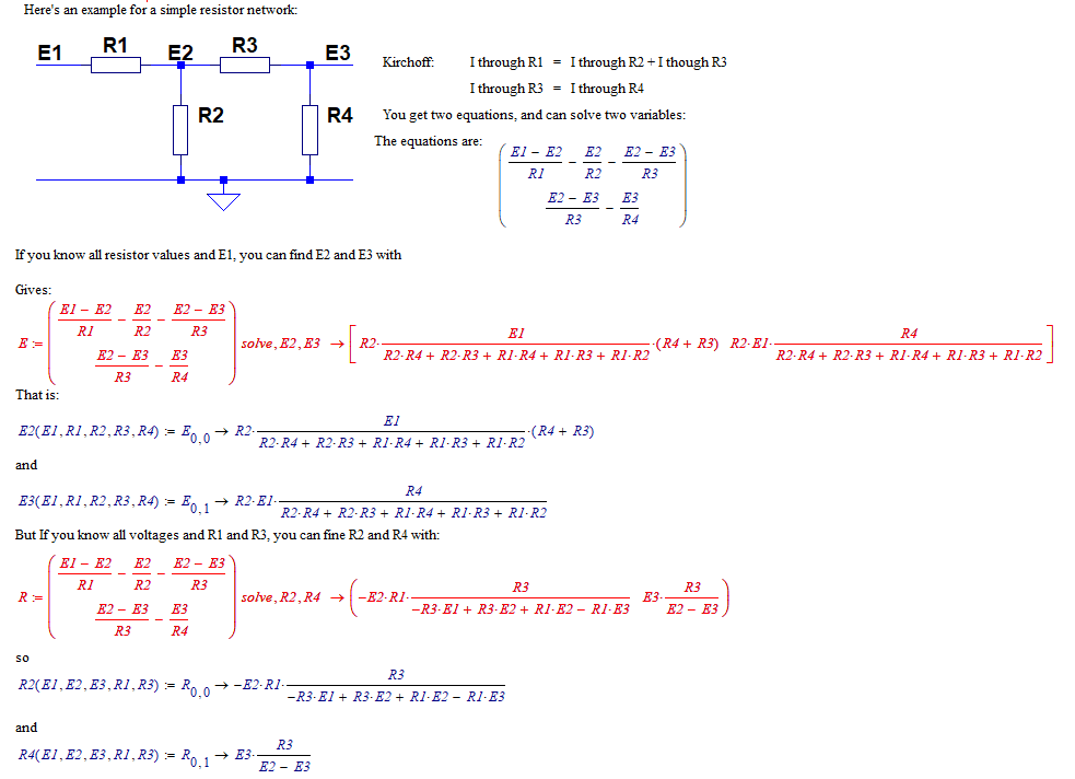

With this example, you should be able to enter your stuff.

You have ten unknowns and ten equations.
You can use a solve block for numeric answers.
Please post you worksheet and I can show you,

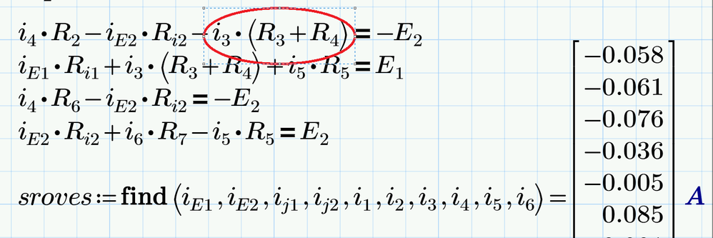

But now that I have an example and tried almost copy paste it to fit to my project I get an error with a command Find. The error is "This value has to be a function". I have no idea what to do again... Any tips?
I'm attaching my worksheet
Ohhh... I'm sooo blind. Thank you very much!!!

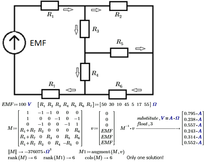

But I must say - better use the lsolve not find function for this problem.
See please 2 my pictures above!
