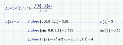

LucMeekes
(To:Andre70)
Ad.2.
If you define it as a function of all parameters, you can do without error:
Then the function you want to get the slope of doesn't need to be defined beforehand:
