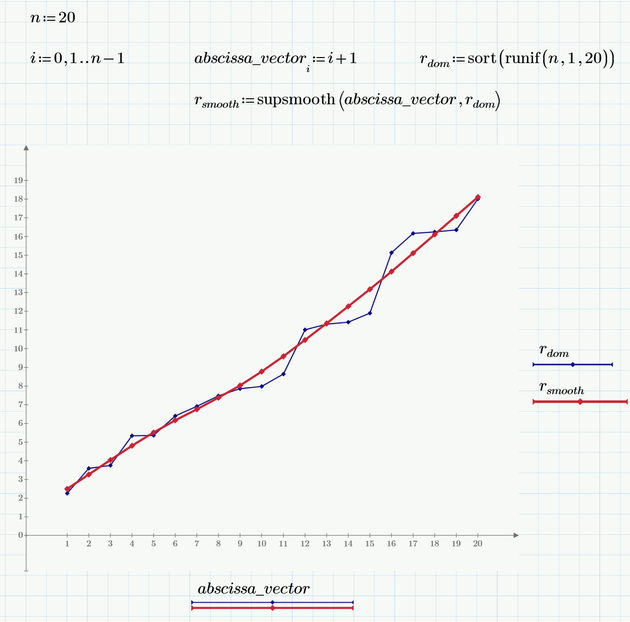

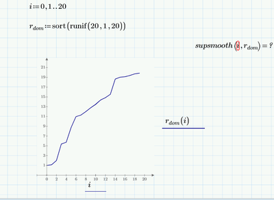

Your approach failed because i is not a vector but a range!
In the pic below I used an undocumented trick to turn a range into a vector by adding a numeric evaluation when defining the variable i. Furthermore I chose the first value to be 1 instead of zero so the magnitude of i and r.dom match.
But of course you are on the save side if you define the necessary vector the "legal" way:

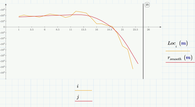

Sorry wasn’t clear. Can’t plot the smoothed  data.
24-Ruby V
(To:ppal)
I don't  see any attempt to plot r.smooth ??
Maybe you just have to move down the plot below the definition of r.smooth?

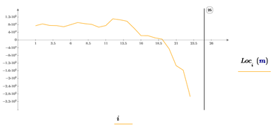

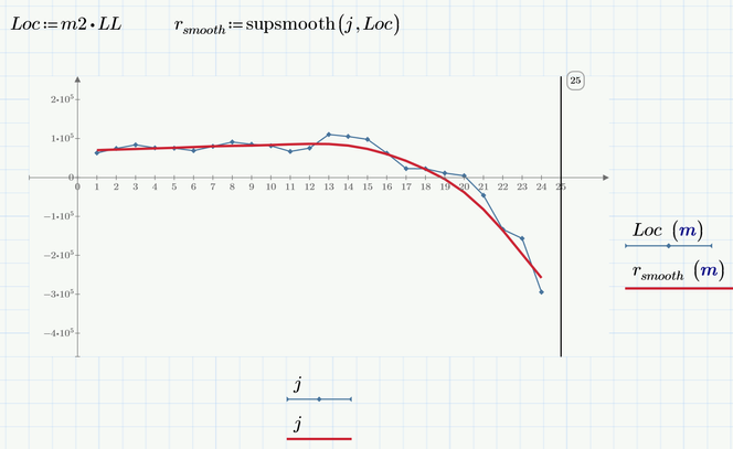

An additional remark:
It looks like you got confused by the indexing of vectors. By default Prime starts with zero.
You defined your range i starting from 1 and then plotted Loc[i over i. That way your plot gets shifted to the left for 1 unit - the first value of your data vector "Loc" is ignored and the second one (index 1) is assigned to 1, etc.
Correct plot should look that way:
