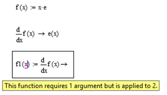

Guess this is a bug in Mathcads symbolics or am I missing something?

The workaround you show does not need the UnitsOf(e) part. It works simply because of the inline evaluation, which redefines e as a simple float number. It looks like e is defined in the symbolics as a function e(x) and this fact should not show through, thats the essence of bug, I guess.
This would explain to some extent the error message I get - Mathcad seems to think that I am trying to evaluate e(x)(x) which equals e(x,x) but "function" e only accepts just 1 argument, not 2.
Not sure about that explanation, though.

Yes, the reason seems to be that even in float mode the symblics first simplifies symbolically (at leat partial) which gives us exact "e" (or the wrong e(x)) and applies float mode only after that.
So 1.0*e^x does not do the trick, while e^1.0 does.

The bug (yes it's a severe bug!), already occurs in the second line/expression.
The derivative of x*e to x is NOT e(x), but simply e.
Mathcad11/Maple translates that to exp(1), which is correct to some extent. It's bad in the sense that you cannot have a symbolic variable called e, that means something else than exp(1), but I can live with it. According to ISO 80000, variables should be written in italics, well known mathematics constants and functions should be written in roman (upright) style. Then a variable called e could be anything , but e=exp(1).

The (symbolic) derivative of f(x) to x is exp(2) according to Mathad11/Maple.

However, if I represent e with exp (1), the result is acceptable:
(To:-MFra-)
Yes, thats just another way to force the symbolics into float mode. As shown above this gives a a correct, but only a numeric result - not what we would expect from symbolic math.
Above I used "e^1.0" and you used the equivalent "exp(1.0)"
Its bad to know that we can't/shouldn't use the exact e in some symbolic calculations but rather have to resort to a numeric approximation.

but if I use "substitute 2.7182182...=e" , which makes the whole thing a bit redundant, I get the correct symbolic result:

But this bug has to do with the symbolics (muPad) and as shown by Luc is not present in MC11 with Maple. So I guess its there since MC14.
