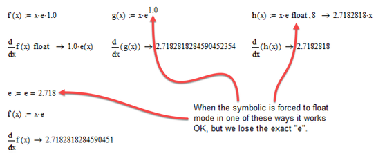

Guess this is a bug in Mathcads symbolics or am I missing something?
Thanks. This bug must be know.
The workaround you show does not need the UnitsOf(e) part. It works simply because of the inline evaluation, which redefines e as a simple float number. It looks like e is defined in the symbolics as a function e(x) and this fact should not show through, thats the essence of bug, I guess.
This would explain to some extent the error message I get - Mathcad seems to think that I am trying to evaluate e(x)(x) which equals e(x,x) but "function" e only accepts just 1 argument, not 2.
Not sure about that explanation, though.
For function g and h the answer for the derivative is now correct. For f it still is NOT.

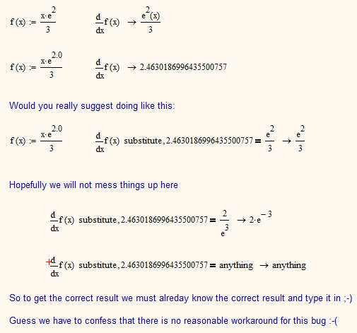

Yes, the reason seems to be that even in float mode the symblics first simplifies symbolically (at leat partial) which gives us exact "e" (or the wrong e(x)) and applies float mode only after that.
So 1.0*e^x does not do the trick, while e^1.0 does.
The bug (yes it's a severe bug!), already occurs in the second line/expression.
The derivative of x*e to x is NOT e(x), but simply e.

Here is another strange effect I noticed while playing around:
The (symbolic) derivative of f(x) to x is exp(2) according to Mathad11/Maple.
That won't come as a surprise for you I guess.
Right, neither the result itself, nor the fact that Maple can deliver this result correctly is surprising 🙂
Hello everyone,
However, if I represent e with exp (1), the result is acceptable:
Yes, thats just another way to force the symbolics into float mode. As shown above this gives a a correct, but only a numeric result - not what we would expect from symbolic math.
Above I used "e^1.0" and you used the equivalent "exp(1.0)"
Its bad to know that we can't/shouldn't use the exact e in some symbolic calculations but rather have to resort to a numeric approximation.
but if I use "substitute 2.7182182...=e" , which makes the whole thing a bit redundant, I get the correct symbolic result:
Not reasonable IMHO !

@-MFra- wrote:
I would never do such a thing.
Neither would I - that was the point. Its no practical workaround.
You wrote that by doing so "...I get the correct symbolic result" but in fact you get any result you like depending on whatever you substitute. You have to already know the correct result to apply the correct substitution.
