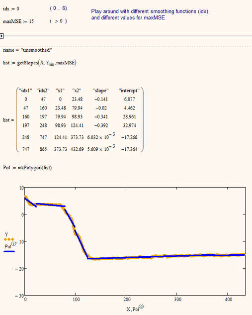

Hello everyone,

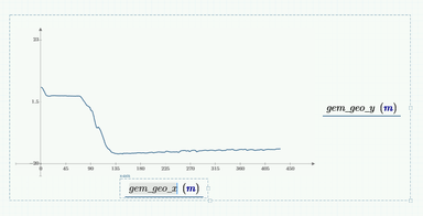

I have lots of datasets with different embankment profiles, see picture for example. Each embankment contains 1 or 2 slopes.
Is it possible to calculate the slope (in this case 2) within the profile. How do I select my boundaries for each slope on the x axis. I can connect my data trough excel as import or make x-y tables/matrixes in mathcad.
I use mathcad prime version 3.
Thanks in advance
Gerwin

How would you define a "slope" in your case?
It would be a good idea to attach a worksheet (you may have to zip it frst to be able to do so because of a nasty bug in the forum software here) with some more example curves.

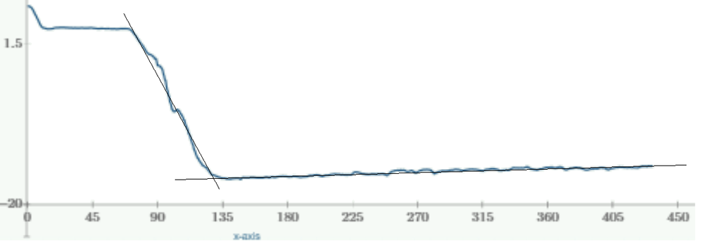

Let me try to clarify a little bit more and add a file with the data of the profile.
In the profile you can see 2 slopes
-1 small one in between 2-12
-2 and a large one in between 72-130.
I would like to calclate the slope of both. I started out with 1. Can mathcad predict the begin and endpoints of slope locations if the data would change a little and what happens if there is like a gap in my data(or is this going to be user input in my sheet). The data in this case is a geometric profile of an embankment.

But to make it clear:
You are interested in the regions where your signal has a slop (a first derivative) different from zero.
And you want Mathcad to determine those sections (Mathcad sure can't predict anything which will change if you change your data in an unspecified way).
It may be possible to do. You may create a spline interpolation function (maybe smoothing the data first), define its derivative and look for the regions where the absolute value of the derivative is grater than a specified threshold. The range from 135 to 450 sure has a slightly positive, non-zero slope but obviously not big enough for you to be interested in.
A second idea would be to simply look for positions where the derivative changes sharply. Maybe looking at the second derivative.
In any case its sort of playing around to find a suitable algorithm and it sure would be necessary to have access to more than just one set of data.

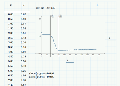

Your slope function calculates the slope of a straight line fit to the entire vector set; I believe what's needed is the local slope of selected sections.
So?
Valery,
OP noted in a reply yesterday that they are looking for the slope between 2-12 and between 72-130.
I couldn't open your Prime (3.1 or 4.0) file--I've got Prime 3.0.  So I digitized your original picture to get a data set for this example.  It's rough, and I haven't tried to automate the detection of slope changes, but it should give you and idea or two. . .

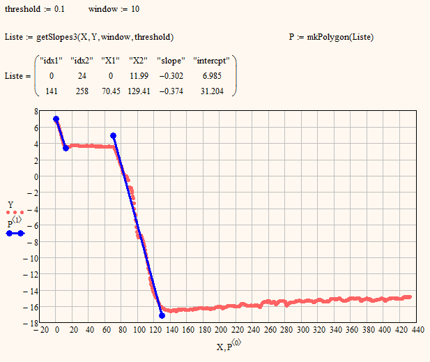

Here are some attempts to automate the finding of the segments with a higher (speaking of the absolute value) slope than a given threshold which does not use an interpolating function and its derivative.
The first approach would need a different kind of smoothing function, I guess
The second approach might be useful. You may have to play around with the parameters and I can't tell if one set of  parameters would be appropriate for all your data sets - you had just provided one.
The sheet was created in Mathcad 15 (what else) and I attach the original MC 15 sheet along with a pdf print as well as a converted Prime 4.0 sheet.
Guess there sure are people out there able to provide a file converted to Prime 3.0 if necessary.

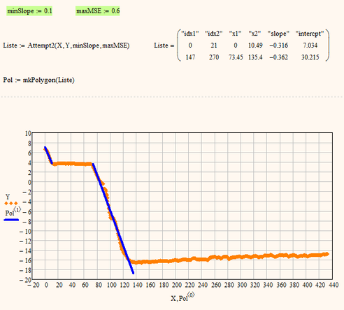

Here are two more attempts, using a numeric discrete derivative but again no interpolating function.
You'll have to give it a try with some others of your data sets.
Sorry, can't attach a Prime 3.0 sheet at the moment. If you ask I am sure someone will be able to convert the MC15 file to Prime 3.

Thanks. This might help. In the worksheet you sent, the vector Ysm was missing. Hence I did not see the blue lines in the mathcad charts.  I would appreciate if you could please resend the worksheet with Ysm.
(To:adar)
Y.sm is not missing, its "hidden" in the collapsed area above.
Just click the plus sign to the left . In case you are using the version for real Mathcad (MC15) you have to double click the arrow to the left of the line. You can also see whats inside this collapsed area in the pdf print I attached.
In the region the smoothing is done and the user can use one out of a couple of smoothing methods by chnaging the value of idx. In real Mathcad we would create a dropdown list to chose from but in limited Prime this option is not available.

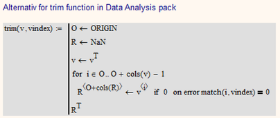

yes, sorry, I realized it later. However, in my version the extension pack is not installed. Hence I cannot use medfilt1d. Regardless, I used Ysm=Y and it workded but in the second function (attempt2), trim(L,killer) could not be used too (due to the same reason about the extension pack). Is there any alternative to it?
(To:adar)
Yes "medfilt1d" is part of the Data Analysis Extension pack and "trim" is part of that pack, too.
But some filters like medsmooth are part of the "normal" Mathcad distribution and should work in your version, too. As far as I remember in very old versions of Mathcad this extension pack was distributed in the form of normal Mathcad functions which you could read and modify. So if you by chance (and Googles help) you can find an old version ... I also think some routines were posted here in the forum, too, now and then (but I wasn't able to find an appropriate thread when I gave it a quick try now).
If you know what the functions are supposed to do you may write your own equivalent Mathcad functions (in fact I am not sure about the differences in medfilt1d vs medsmooth).
In case of "trim" here is a quick hack which should do the job without the DAE pack, too.
Worksheet in MC15 format attached.
