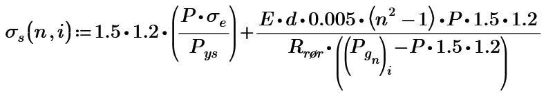

Hello.
I am having troubles with the outputs when the range variable "n" is used (file attached).
The range variable is defined from 2 to 6 with the step of 1. So there are 5 elements in 5x1 matrix.
But at some point during the calculation I get more than 5 outputs (parameters L_e, A_e, X_e, I_e and Pg.
What did I do wrong in my spreadsheet? I will appreciate any feedback.
Best regards, Sergey
Hi Sergey,
Never confuse a range index with a vector of scalar values.  A range is not a variable it is an index.
Have substituted ni as the range index for addressing or indexing the values in the n scalar column vector variable
Cheers
Terry

Thank you, Terry.
I get what I did wrong. Will make sure to remember it.
