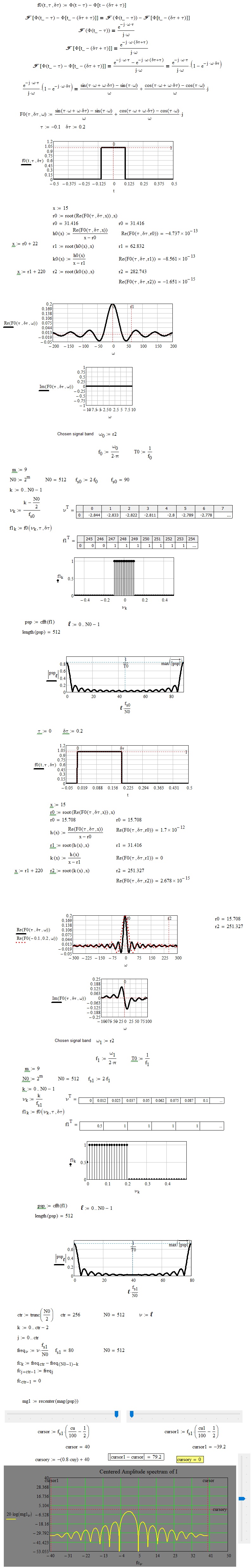

I used MC15 getting this result ....... I'm sorry are missing the comments ......
