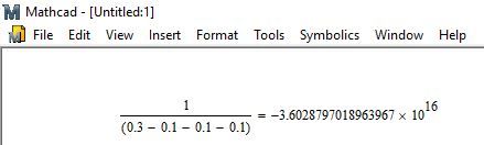

Hallo,
found something strange in the calculation when i show all decimalpositions
Is there any plausible explanation?

You will see similar effect with most software which uses the usual IEEE fomat to store floating point numbers.
This format will provide a precision of 15-16 decimal at max.
In case of Mathcad there is additionally a chance that numerical roundoffs are introduced by the use of units. The units you provide are converted to the base units, then the calculation is done in base units and for display the result is again converted to the units you demand to see.
The error you show is just 2*10^-18 m.
If you really need more precision you'll have to use the symbolics.

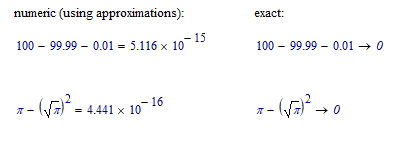

Here's another classic one:
digital math accuracy.
Early on in my class on FORTRAN we covered the fact that each computer math operation introduced the possibility of a small random error, and that these accumulated   If you add (or multiply or divide) a sufficiently large quantity of numbers you will get an incorrect answer.  This introduced the concept of significant digits; and that's what you're illustrating--the last digit in your response (and based on the two decimal length of your inputs quite a few of the trailing zeros) are not significant.
FredLusk
(To:sm�ller-2)
Did you know that 100 – 99.99 – 0.01 = 5.117…x10^-15?  Well, according to most software, it is.  🙂
In all my years of testing this and similar subtraction problems, the only things that always produced the correct answer were my Hewlett-Packard and SwissMicros calculators (which use binary coded decimal rather than floating point math), Q&A 4.0 (an old DOS-based database program) and Word for Windows 2.0.  Q&A 4.0 and Word for Windows 2.0 accomplished this by rounding off the result to something like 7 or 8 decimal places.  Newer versions of Word, and various versions of Autocad, Supercalc, Excel, Mathcad, etc. all produced the non-zero answer above due to the limitations of floating point math.
Thomas Okken's Free42 simulator of the HP-42S calculator comes in two versions:  binary (IEEE floating point) and decimal (BCD).  The binary version produces 5.117…x10^-15 and the decimal version produces 0.  My SwissMicros DM42 calculates with 34 digits (!), but it uses BCD and produces 0.  The DM42 also has an incredible dynamic range of about ±10^±6145.
BTW, some subtraction problems similar to the one above do produce zero using floating point math, it just depends on the specific numbers being used and the precision to which the calculation is being carried out.  I have a spreadsheet at home with several hundred successful and unsuccessful calculations of the same form and which software I tested them in.
Why do I test this type of subtraction problem when tiny, non-zero results are irrelevant to the types of civil engineering problems I encounter?  Because I sometimes have to test for zero, a non-zero result for zero causes all sorts of problems, and I need to know how each software program responds.  So, the moral of this story is to round off or set a tolerance before testing for zero.

LucMeekes
(To:sm�ller-2)
Neither does Mathcad, if you use it correctly:

LucMeekes
(To:sm�ller-2)
It's not weird. The symbolic processor of Mathcad will, if it can provide an answer, give you an exact result.
That's even better than the BCD numeric approximations with rounding that e.g. the HP 42 calculator gives.
