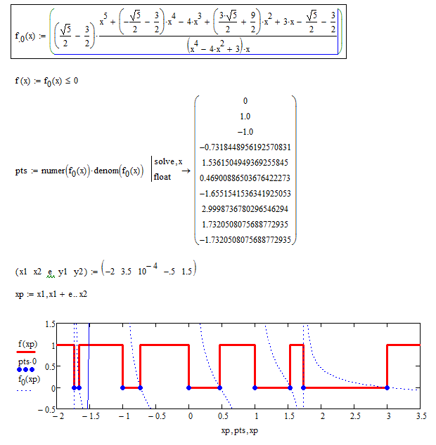

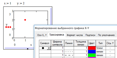

   Hello, Everyone.
   From :
  How to plot 8 upper-corner-points ?
     Thanks in advance.
         Regards.
LucMeekes
(To:lvl107)
Like this:

LucMeekes
(To:lvl107)
Like this:

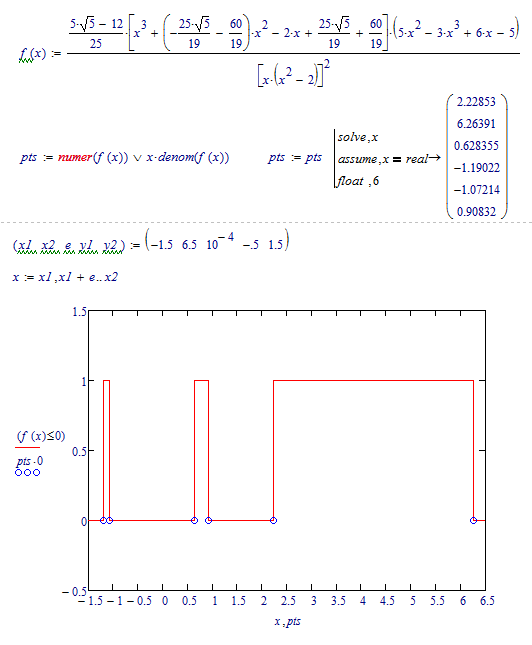

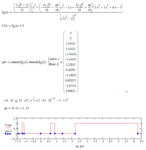

lvl107
20-Turquoise
(To:LucMeekes)
Luc, I don't know the reason the plot doesn't show up in this case.
    Regards.
         Loi.
(To:lvl107)
You have disabled the plot region!
Right click the plot region and chose "Enable Evaluation"
As you can see the poles at +/-sqrt 2 and 0 are no valid solutions to your problem this time. This is because they are poles of second order (the square in d(x)) and so there is no change of signs at those positions. A sign change only occurs at poles of odd order.

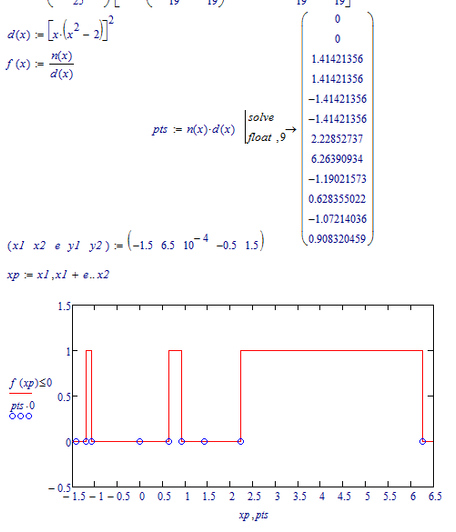

lvl107
20-Turquoise
(To:Werner_E)
   Many thanks, Werner. And how to keep the same "procedure" and eliminate 3 points are not 6 lower-intersection-points ? ( maybe just edit ? ). ( And how to plot local minimum-points of the f(x) ? )
   Best Regards.
lvl107
20-Turquoise
(To:lvl107)
Correction : plot local minimum-points of the f.0(x)
(To:lvl107)
You may think beforehand and don't ask for the zeros of the denominator which are of even order. In your example obviously all are of even order and so you would not ask for d(x)=0 at all.
As an alternative you may consider writing a function which eliminates all points of zeros (nominator and denominator separately) which occur an even number of times. This routine also must consider removable discontinuities like when nominator and denominator have a common zero. Good luck!

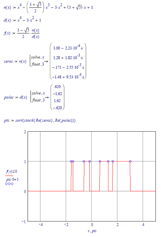

lvl107
20-Turquoise
(To:LucMeekes)
Luc, after I have got all of your hints, I try to plot all lower-intersection-points of logical-plot, but I don't know it's true for all of cases :
       Best Regards.
           Loi.

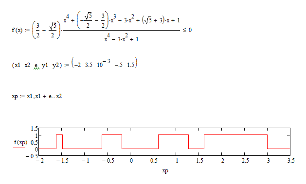

lvl107
20-Turquoise
(To:lvl107)
  Oh, my trial is fail.
      Missing point.

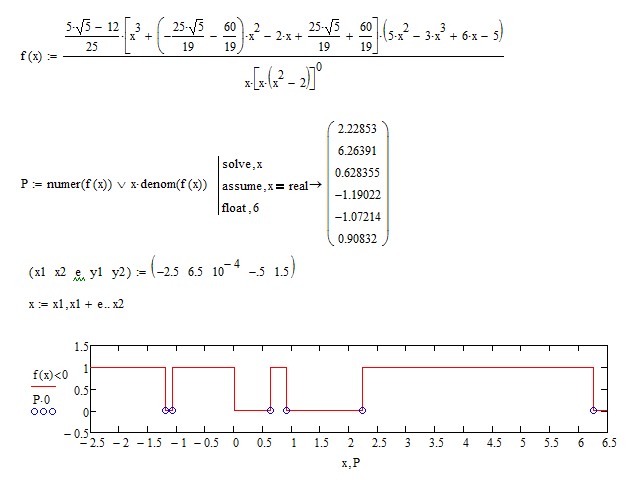

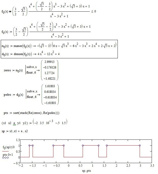

-MFra-
(To:lvl107)
You could also use the "numer" and  "denom" functions as shown:
(To:-MFra-)
or more compact:

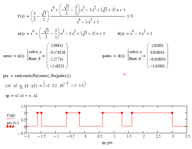

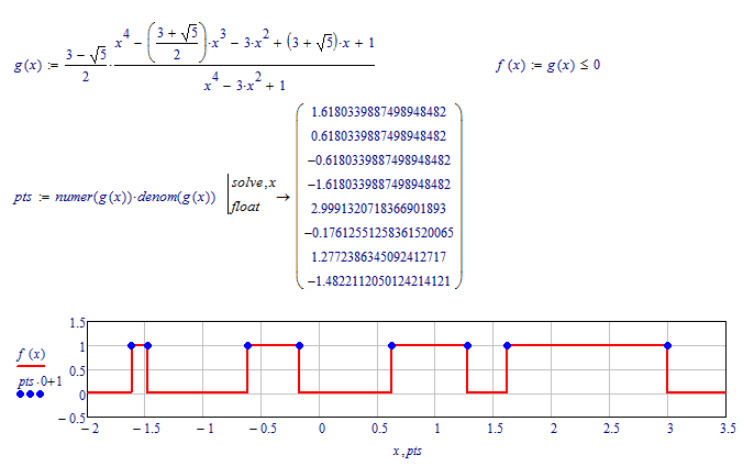

lvl107
20-Turquoise
(To:Werner_E)
  F.M. and Werner, with your "procedures" above, It seems that I just need "input" a new function ! Smiley HappySmiley HappySmiley Happy :
  Many thanks for all your time and help.
