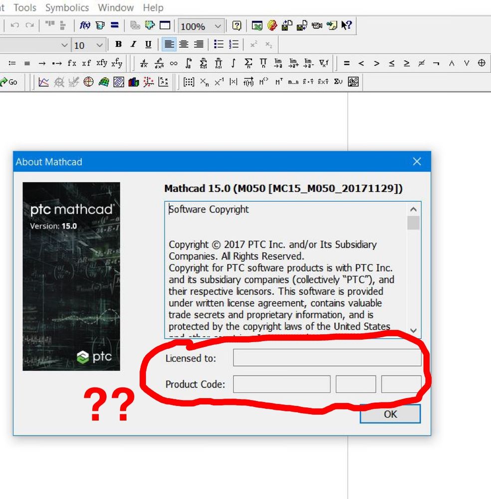

Upgraded computer to Windows 10 and now cannot get Mathcad 15 to install with my product code.  Your website for license management wants a Host ID and I have no idea what that is.  Why does PTC make life so difficult.

I have installed it both ways (license and Product Code).  They both show the following when I click on Help>About Mathcad.  So I was not sure I had a permanent installation.  As of just a few minutes ago, your support staff assures me that I do indeed have a licensed,permanent installation.

As you already mentioned you have a product code for student edition there is no need to look for Mac address.
Kindly browse to the following installation location (It may vary as per you installation location)
C:\Program Files (x86)\Mathcad\Mathcad 15\mclicense > Run mclicense.exe > Select > I want to acquire a license via the internet > Next
Select the purchase of the license (in your case Educational- Student) > Enter product Code > Select Next > complete the license setup.
Kindly confirm if this helps.

That may all be, but as I knew it, a edu product code would be valid for ONE installation only (unless it has changed in the meantime). This means that you would be unable to install the software a second time, neither on another, nor on the same machine (even though you are entitled to do so). The usual advice is, that if you have to reinstall the OS on a machine and therefore need to reinstall Mathcad, you should save your license file as you can use it for the new installation on the same machine. Otherwise PTC has to create a new license file for you.
You have running multiple threads here concerning your very same problem. In one of them you mentioned, that you already got a new license file from PTC and managed to install Mathcad. So the actual problems seems to be that you don't see your name in the about window (which I would consider a minor problem) and that you don't can use the help system (which is a major problem and should be something PTC support should be able to help).
@regcurry, Please create a case with PTC to get the desired license file. To know the host id of your machine follow the below steps.
Click Start > Run > type cmd > OK
Run Windows command ipconfig /all
Computer's physical address is value of "Physical address" field under Ethernet Adapter Local Area Connection
