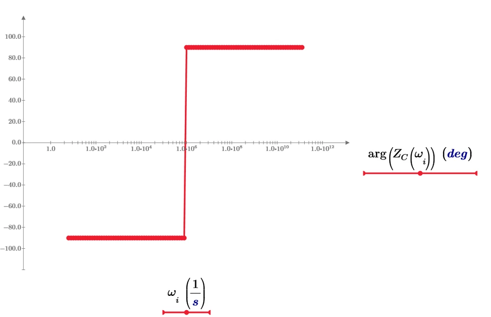

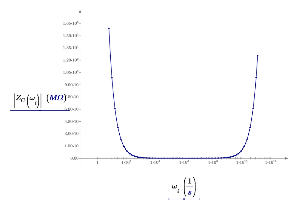

I am trying to model a capacitor based of the input values for L and R and plot the results.
If I plotting unit-less then the calculation is OK, others I get wired values for Xc and Xl.
Can somebody can point me where is the problem?

Thank you to all for your quick answer.
I am still not able to plot the values. It is drive me crazy. For such a simple thing, I still cannot find error.
ttokoro
March 18, 2024
Attach it.
