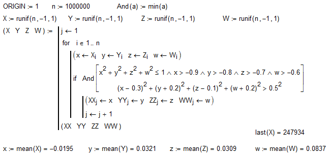

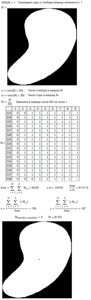

The article proposes a laboratory work at the intersection of physics and computer science: the definition of the center of gravity of a plane arbitrary figure, as well as a physical body of an arbitrary shape.
Keywords: flat homogeneous figure, a homogeneous body, the center of gravity, center of mass, the scan pattern, random number generation, matrix, Mathcad.
Mathcad 15 sheets of the article in attach.
Pictures:
Fig.1. Definition of the center of gravity of a flat figure
Fig. 2. Determination of the center of gravity of a flat uniform black and white figure

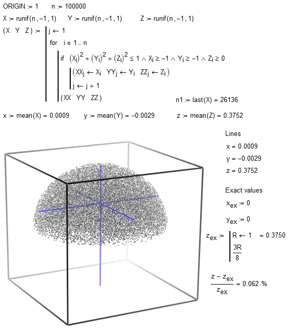

Fig. 6. Determination of the center of gravity of the hemisphere
