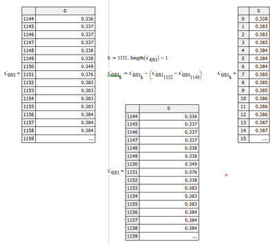

I would like to shift the values of the last part of a table. Is that possible?

Use the submatrix() function, possibly together with the stack() function.
Or do you mean to change their values instead of their position?

I would like to change the values of the last third or so, by a tiny bit.
I suppose I could maybe use the submatrix and stack to: disassemble, manipulate and reassemble.
Or is there an easier way?

Something like this:

Thanks!
I have never used such operations before. How do you get it to run?
LucMeekes
(To:MWinther)
Press the [F9] button.
(By default in my sheets, automatic calculation is switched off)
