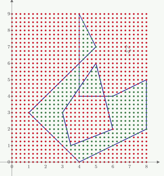

I recently calculated wave theory selection using Mathcad Prime 9.0.0.0. I'm curious, is there a way to determine the region automatically for given points? I want the function to return "Linear/Airy", "Stokes 5", "Stream Function 3", etc. based on the chart.
Does anyone know? I attached the full calculation below.

No, Prime does not offer any automatic way to determine which area a given point would lie in.
You would have to program a function which determines which area a point with given coordinates is in and also would have to decide what to do with points lying on the border of two or more areas. Looks like quite some work to do.

Hi
A while ago dealing with vector based text fonts in bitmap graphics on this forum wrote a Mathcad 15 routine to find if a point is in a polygon.
If the areas on your excellent graph are turned into polygons it is possible to test where a point lies.
This will take a while to work up so please be patient.
Cheers
Terry

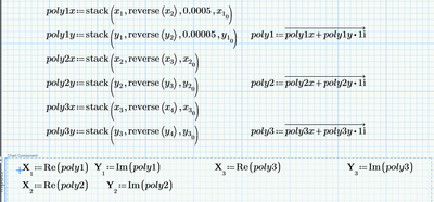

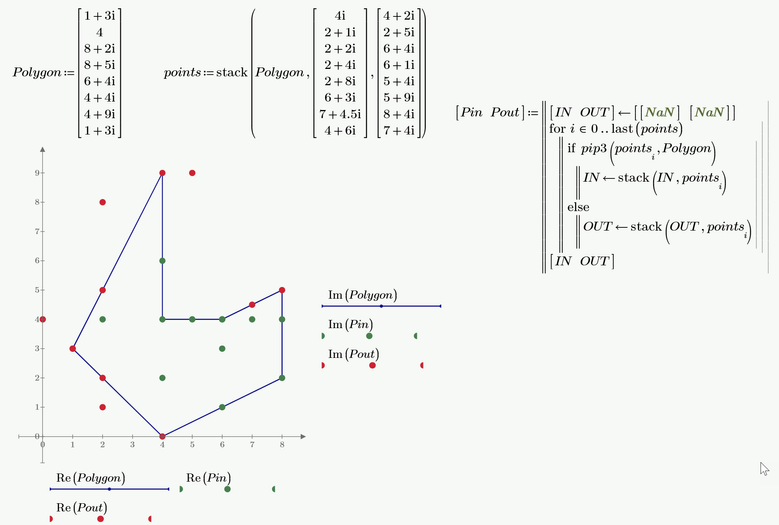

Here is the start on point in polygon method to determine where a point is.
It uses a complex variable for each point with Re() being the x coordinate and Im() being the y coordinate.
I would rather do this than rewrite the point in polygon functions.
Cheers
Terry

Yes just keep going until they are all defined.  The method I have shown here results in for example poly2 a figure eight shape that should be sorted out.  That is why I have asked for the excel sheet with the lines in.  In poly1 I have added the bottom left corner of the graph as well.
Also, can you explain what do these loopings do? Please explain the mathemathical forms into sentence

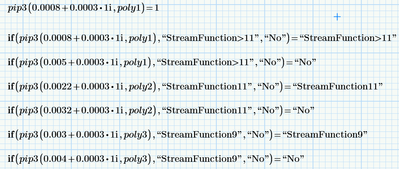

The pip3() function stands for point in polygon version 3.  The function takes a point and a polygon as inputs.
It returns zero (means false) if the point lies outside the polygon.  It returns 1 (means true) if the point lies inside or on the boundary.
This zero and one result can be used in an if statement to make a choice between two options true and false.
I have given examples of a point inside (gives the name of the region) and an example of a point outside (gives "No") of each of the first three polygons.
In the end I would write a program to test all the polygons in turn to determine which one the point lies in.
A complex variable for each point is used for points and polygons with Re() being the x coordinate and Im() being the y coordinate.
Above is a sample of a point inside poly1

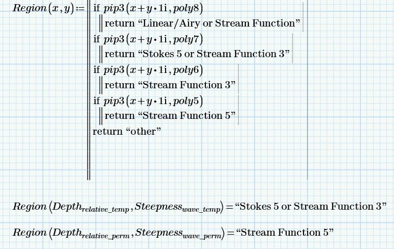

Here is a sample of the final function to select a region.
Completed worksheet.

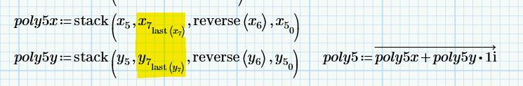

Alteration to poly5 to square off the top right corner:
Cheers
Terry

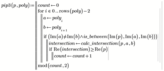

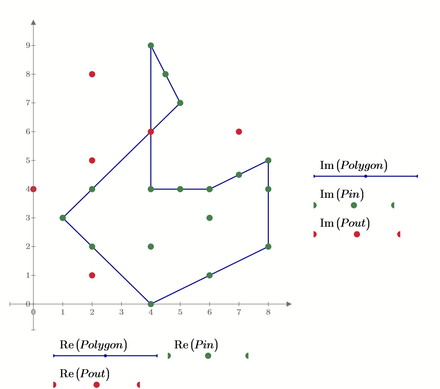

Nice implementation of the Jordan scanline algorithm. Works quite well apart from a minor inconsistency with vertex points or points on polygon edges. Some of these points are seen as interior points and others are not.
You may streamline the is_between function to
and you could get rid of the if-statement at the end of the pip3 function
BTW, in "pip3wh", why do you exclude hole-polygons starting at the origin with
Werner_E_1-1758236155284.png  ???
In the attached sheet I added an winding counting algorithm quickly converted from an old Mathcad sheet and called it "pip4". When I look at it after that many years I have the feeling that is sure could be written more simplified.
pip4 still seems to have a problem with the point(s) of intersection of self-intersecting polygons.
Maybe the Dan Sunday algorithm would be a better (and faster) alternative?
Prime 9 sheet attached.
Prime 9 did not allow me to save the sheet while the original Chart component was embedded. (I know why I hate and avoid the chart component). So I deleted all but the "pip" functions and the demo polygon.
So this sheet does not deal with the original question but the function pip4 within sure could be used to determine the area a point lies in once the polygons are defined correctly.

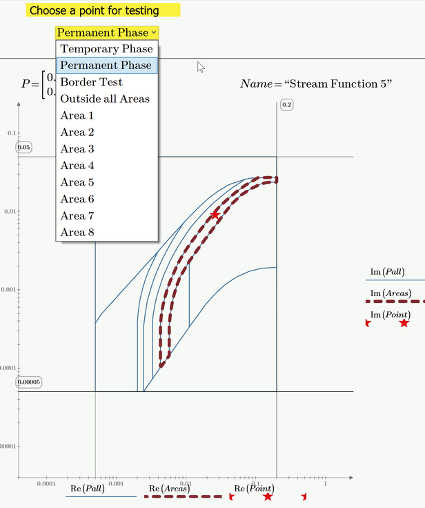

Added another "point-in-polygon" algorithm "pip5".
Its basically also a ray casting algorithm counting the number of intersection points with the polygon edges to the right of a given point.
But it distinguishes between three possible positions with its return value: IN the polygon (2), ON the polygon (1), and OUTSIDE (0).
So I derived two functions, pip5a (including margin) and pip5b (excluding margin), for testing purposes.
The four algorithms included so far can be selected via a simple combo box.
Feel free to play around and report any problems or discrepancies with the algorithms.

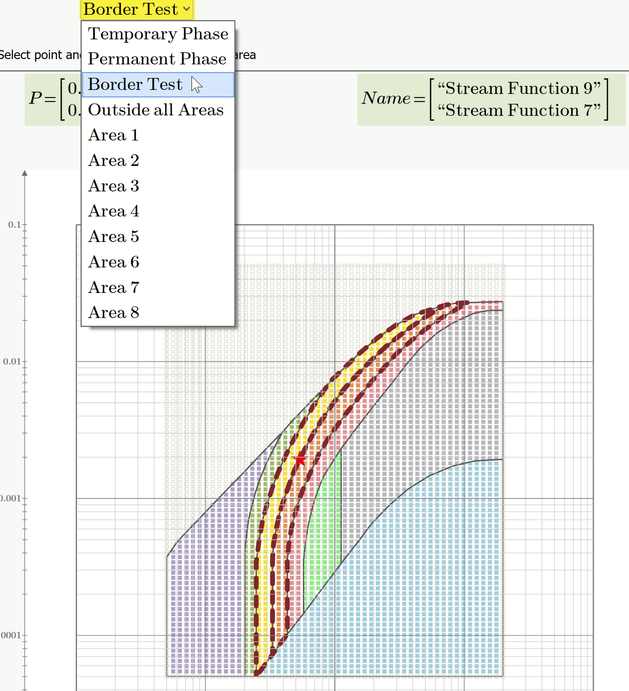

Here is my attempt defining the necessary polygons and determining the area a points lies in:
After saving the file and reopening it the region with the Chart component was corrupt and so I deleted it.
Prime 9 file attached
(To:Werner_E)

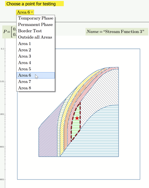

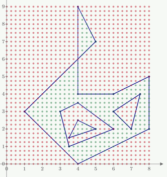

Added the hatching function by Prof. Birkeland.
Unfortunately the creation of all the hatch lines is very time consuming and the result is not as nice as we would like. Guess its also because of the log scale.
(To:Werner_E)
Hatching took far too long in my opinion. So I implemented a simpler approach, filling the areas just with dots.
Also added grid lines.

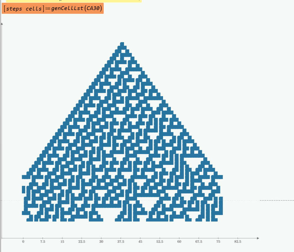

StuartBruff
(To:Werner_E)
By coincidence, I've (literally) just started looking at an old Express worksheet that generates cellular automata.  I used dots as a workaround for the missing Picture component.
A thicker line style fills the space better, but looks a bit more brutal (IMO).
Stuart

StuartBruff
(To:Werner_E)
Bittet, so wird euch gegeben ...
A triangle variant, so it does look like CA30.  I've changed the initialisation for this one, otherwise it was difficult to see.  A problem with the 2D Plot method for displaying CAs is that one can only display so many points before the display can only show single circles of minimal thickness.
Stuart
