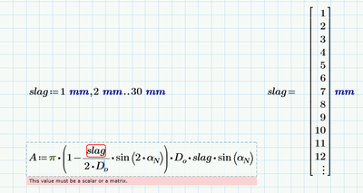

Hello!
Does anybody know how to change the units (from m to mm, m^2 to mm^2) in the chart component graph?
Please, take a look at the attached file.

LucMeekes
(To:Sergey)
What you try there indeed does not work with a range:
It runs without error with a vector:
But I think you are looking for this result:
That is, you need to vectorise the expression.

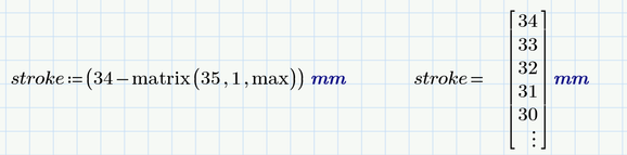

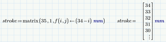

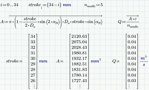

(To:Sergey)
You probably misunderstood what i wrote in the file. I meant that it is not necessary to use the vector index "i" after you already created the vector.
For creating the vector "stroke" you can use the range variable "i" as you did, but when you calculate A and Q the index can be omitted, but you will have to vectorize (the arrow over the expression) the calculation so that Prime knows you want the calculation to be done for each element of the vector(s) and don't use vector multiplication.
Vectorization is mandatory in the calculation of A because the expression in the parenthesis is a vector and the expression after it is a vector as well. So Prime would apply vector multiplication resulting in one single scalar value.
Vectorization would not be necessary in case of the calculation of Q but I consider it good habit (and it avoids mistakes) to always explicitly vectorize calculations when a calculations should be applied to the elements of a vector and not the vector itself.

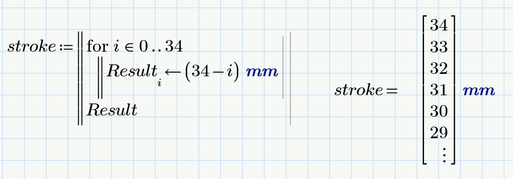

There is nothing wrong with the way you created your vector "stroke" using a range variable "i" to index its elements, but there are also other ways to create a vector.
You could use programming and a for-loop
Actually that's quite similar to the range approach as basically a range is sort of an implicit loop and not a data structure.
You may also use the "matrix" function as Luc suggested
or using the "max" function as Luc did

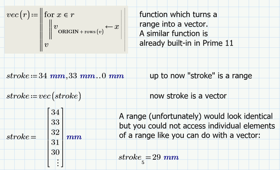

Or you may use a range and turn it into a vector. In Prime 10 you have to use a user-function to do so, in Prime 11 a function "vec" is already built-in:
Benefit of the methods shown is that you don't need to define an extra global variable (the range "i").
So chose your weapons ... 😉
