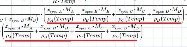

Small suggestion:- assigning the last element of a vector sets the memory to the final size in one go.
If you don't do this the memory for the vector needs to expand at every assignment during the loop and this is not efficient.

1. The vector wirting, it is better to create a vector of each variable instead to overwrite the actuall value?
Sorry I misread the pdf.  I thought you were creating vectors for m and V.  I misread the second letter of the variable name as subscripts.  I misread the letter "l" as"i".  I am not suggesting you use vectors.  Sorry for the misunderstanding.  Overwrite the variable is faster.
The second suggestion for speeding up stands you only need do four interpolations using Temp outside the for loop instead of 800 interpolations inside the loop.
Regards
Hi
second suggestion for speed up and this will make a large difference to the time.
The linear interpolations involving Temp in the first two lines after the for loop i = 0 .. 100 should be taken out of the loop as the variable Temp does not change inside the for loop and the interpolations are constant each loop
Take these interpolations out of the loop by assigning four new variables in the program.
