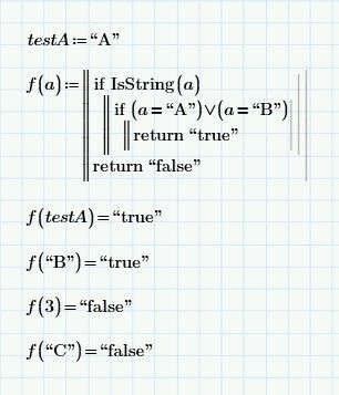

I have seen compound IF statements that evaluate numerical values.  e.g.  if (a=1,2,3)
How can I construct a compound IF statement where the variable being evaluated is text?  I want the IF loop to run if the text value Fault is A or B.
e.g.  if (Fault="A", "B")

Like this
Cheers
Terry

Like this
Cheers
Terry
Well, there it is.  Thank you Terry
