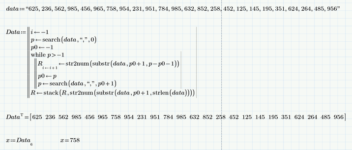

3) Switch back to Prime and type "data:=" (without the quotes) and then press Ctr-V to insert the data. The result should be that you created a string variable containing the data values separated by commas.
4) Now you can write a simple parser to separate the values in the created string, convert them to numbers and store the results in a vector
5) Now you can access individual vector values using the normal ways to deal with vectors.

For those of you watching in Prime Express 7, here's one way of converting a separated string of numbers to a vector of numbers:
Stuart
(sfind isn't really necessary; it's only there to shorten the first line of strsplit)
