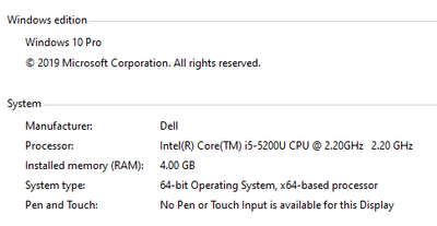

Hi Experts,
Below are my office Mathcad (with legal license) and OS (with legal license) information.
I searched "control(s)" in community, but I can not find final solution. Some posts were posted about 10 or even about 20 years ago...
The problems are that:
1. when I open the quicksheet "Controls and Automation" (Ibelieve you can find the quicksheet in mathcad folder, anyway i save as and upload it), the button does not work. see below screenshot
2. Another problem is that when I Insert -> control -> Push button (or other controls or Web control...), nothing apears. Also, Insert -> Data -> Table, nothing apears.
But my own home computer(Win 10 OS). Mathcad (Mathcad15, need check details) works well without above kind of problems. So for the compatibility, I need avoid to use controls. This is very inconvenience and make sheet to be lower leavel... I try to find solution for years from internet and F1 help. But can not solve the problem.
Because I am not the administrator of office computer, so I can not reinstall Mathcad , but our IT guy helped me reinstall Mathcad several times when I found potential solutions.
All of our R&D office computers that with Win10 system have the same problems. Only one public Win7 computer works well with controls. I am sure that when our office computers were all win7 OS several  years ago, Mathcad controls were all OK. So the problems are related with windows OS?
Strongly hope that comunity experts can give finnal solutions. Thanks

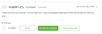

I remembered I posted a same topic when 2014:
https://community.ptc.com/t5/PTC-Mathcad/why-the-controls-are-disable-in-my-sheet-Mathcad-15-F000/m-p/360932#M141178
But the difference is in that post the problem because our office OS update from winXP to win7. And after IT guys reinstall Mathcad, in Win7 OS, the controls problem were solved. Now this time in this post, the OS is Win10...
The Mathcad is still Mathcad 15 F000
