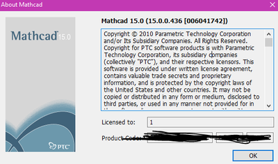

Hi Experts,
Below are my office Mathcad (with legal license) and OS (with legal license) information.
I searched "control(s)" in community, but I can not find final solution. Some posts were posted about 10 or even about 20 years ago...
The problems are that:
1. when I open the quicksheet "Controls and Automation" (Ibelieve you can find the quicksheet in mathcad folder, anyway i save as and upload it), the button does not work. see below screenshot
2. Another problem is that when I Insert -> control -> Push button (or other controls or Web control...), nothing apears. Also, Insert -> Data -> Table, nothing apears.
But my own home computer(Win 10 OS). Mathcad (Mathcad15, need check details) works well without above kind of problems. So for the compatibility, I need avoid to use controls. This is very inconvenience and make sheet to be lower leavel... I try to find solution for years from internet and F1 help. But can not solve the problem.
Because I am not the administrator of office computer, so I can not reinstall Mathcad , but our IT guy helped me reinstall Mathcad several times when I found potential solutions.
All of our R&D office computers that with Win10 system have the same problems. Only one public Win7 computer works well with controls. I am sure that when our office computers were all win7 OS several  years ago, Mathcad controls were all OK. So the problems are related with windows OS?
Strongly hope that comunity experts can give finnal solutions. Thanks

Any chance to upgrade from F000  ("F" means the first release of version 15) to a newer maintenance release (current and last is M050)?
I am not sure though if this would cure your problem as I assume that at home you are using F000 as well without problems, right?
Anyway, I just looked up the readme of M050 and found that it mentioned two fixes which have to do with controls:
Fixed in M010:
Fixed in M020
Furthermore, just to be on the safe side, I'd like to mention that its mandatory that .NET 3.5 is installed (it has to be that version, a higher version won't do!). Check, if that older version is installed on the company workstations (probably along an in parallel with a newer version).
Also, sometimes its necessary to re-register the *.mcm files responsible  for the components as even a re-installation of Mathcad won't do so. Find mcmreg.exe and start it (run as Admin!) and then navigate to the folder with the *.mcm files, usually C:\Program Files (x86)\Mathcad\Mathcad 15\mcm. Select all of them and click "open" and  follow the dialog.
As an alternative it may also work by opening a command shell as Admin and typing C:\Program Files (x86)\Mathcad\Mathcad 15\mathad.exe /register
Because of missing permissions you probably will need the help of your IT Support to try some of the above.
Yes. Confirmed with IT that .NET3.5 is installed
Run mcmreg.exe as admin and register all of the mcm files.
And then I restart the computer, the controls still do not work...

It works!
IT download MATHCAD 15 M050:
https://www.ptc.com/-/media/Files/Docs/Mathcad/Mathcad15-EN.zip
and then Install as amdin into Cdisk. But there is a problem. Mathcad only can run under admin even give the right to me in "Security" tab.  later reinstall it under D disk. Then it works.
BTW, we use flexnet server license.
Thank you so much.
