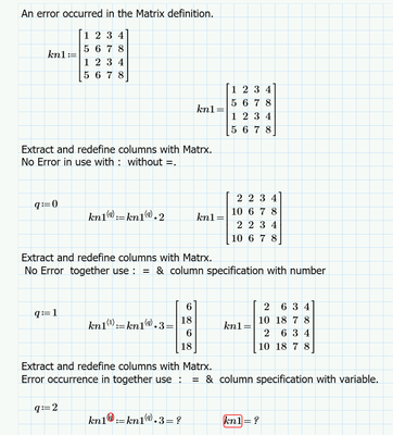

Converting from Mathcad 14 file to Mathcad Prime 11.
An error occurred when extracting and redefining a matrix by specifying a column.
Changing the matrix column specification from a variable to a number does not cause an error.
Why is the error occurring?

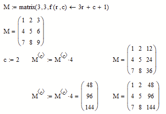

I couldn't resist and gave it a try and its as I suspected:
Prime 11.0.0.0:
Real Mathcad 15:
While it was already a good advice in the old real Mathcad to avoid inline evaluations, the problems seem to have gotten even worse in Prime.
I would call it a bug, and you are free to report it as such to official PTC support—good luck!
BTW, the bug is NOT present in Prime 6 and below. Can't say anything about Prime 7 and 8 because I never had installed these versions.  But the bug definitely shows up in Prime 9, and also in version 10 and 11.0.0.0. Can't say anything about the current version 11.0.1.0 as I have not installed it and PTC is not able/willing to publish a comprehensive list of bug fixes or improvements  made in their various versions.
But at least you now have a work-around - avoid inline evaluations.
EDIT: One final note: Even the genuine Mathcad was not entirely free of such undesirable effects caused by the use of inline evaluation.
If c is a range variable, even Mathcad  gets confused when you add an inline evaluation:
Error message is "This value must be an integer".

I've created a simplified example..
Is this a limitation of Mathcad Prime?

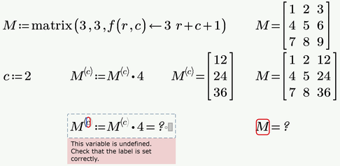

Prime 11.0.0.0:
Real Mathcad 15:
