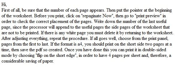

A very important thing to do before launching print preview especially if the worksheet takes up several MB, is that you have to disable the automatic calculation, otherwise you can block everything.
