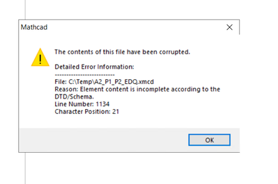

The attached file is corrupted - Element content is incomplete according to the DTD/Schema, Line number 1134, Char Pos 21.
Can some one offer suggestions on how to fix the file?
I simply loaded the file in a text editor (I use Notepad++), located line 1134 and deleted the whole region this line was in. That is the section starting with "<region ..." in line 1112 up to line 1146 with the closing "</region>".

I edited the file and deleted a corrupt region. So obviously there is now missing something compared to the original.
Hope it helps.
Thank you kindly.  If you don't mind, how did you identify the corrupted region?
Yes, its rather bold and there sure may be more sophisticated ways, maybe a way to detect the actual cause of the error and repairing it without having to get rid of the whole region.
