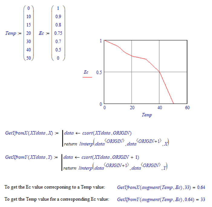

In the attached Mathcad prime 3.1 worksheet (along with screenshot) I've graphed two vectors in an X-Y plot. Is it possible to create a function such that the user can type in any value for temperature( within the highest and lowest value) and receive the temperature back?

I'm afraid you want a function where you give an Ec value, and get the correcponding temperature. That is partially possible.
I think the answer to your question lies with the function linterp(), look it up in the help, and see how it works.
The problem is that there is a temperature range where the Ec value is 1. What temperature would you expect to get for Ec=1?

LucMeekes
(To:LucMeekes)
Here's an example using linterp().
Note that it works because there is a one-to-one relation between Temp and Ec values. If that is not the case (as in your example where Ec=1 on a range of Temp values), the linterp() funtion will complain. In that case using spline functions (see the answer below) may (...) help.

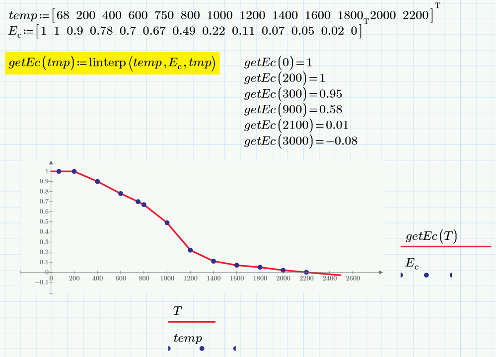

rgunwaldsen
(To:dsochor)
Mathcad provides a variety of methods for fitting functions to data.
Attached worksheet fits cubic spline to your data.

rgunwaldsen
(To:dsochor)
I used Prime 5. PTC has made it impossible to copy/paste stuff into prior versions of Prime.
Attached is "xps" printout.
The functions used are straight out of the help example for "Example: Cubic Spline Interpolation
Example: Cubic Spline Interpolation".
Advantage for cubic spline fit for interpolation within range is that it provides "smooth" function with continuity of function and 1st/2nd derivatives.
Roger
(To:dsochor)
My guess is that you want a function to calculate Ec from a given temp and not the other way round.
If linear interpolation is sufficient you may do like this:
