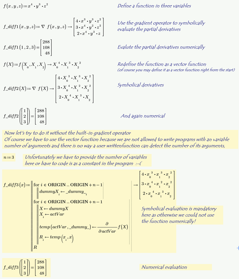

As an example the same demo function with three arguments as posted before
P.S.: I am not sure if the gradient operator already exists in Prime 8, though.
EDIT: I just check and it seems that the gradient operator was not present in Prime 8
See: Solved: Representing Del Operations [curl(u), div(u), grad... - PTC Community
The operator actually was introduced in Prime 9.

This is what the Nabla/Gradient operator is to be used for. Can be used symbolically but also numerically

As a supplement to what was shown earlier: If partial differentiation is to be performed for all variables, it is not necessary to list all variables individually in the Nabla operator; instead, the corresponding placeholder can be left empty in this case:

OK, I gave it a try and here is my best approach to automatically get all partial derivatives without using the gradient operator.
The method sure has its drawbacks and if ever possible you should switch to Prime 9 or higher where the gradient operator is available.
The attached file is in Prime 11 format as I don't have Prime 8 installed. However, you can certainly follow it based on the screenshot.
Hope it works OK in Prime 8 and can be of help.
