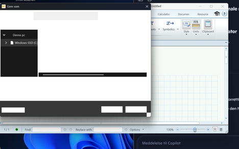

Mathcad prime 10.0.0.0 failing to save
Just as i thought the problem was solved it went back. I tried resetting my pc and downloading everything from scratch. I have a lenovo with windows 11 home. Everytime i try saving a document a corrupt saving page pops up. i will attach it here. Skærmbillede 2026-02-03 122031.png
It happens when i use; save as, save or any type of export.
I have tried reinstalling several times, also as administrator, and it has the same outcome.
When running the program as admin it gives 3 more seconds on the save window but inevitably it crashes again. I made sure i unpacked the download zip-file locally and not using onedrive. Also i placed the app locally.

I tried changing the windows language to english. i still have the same thing happening unfortunately. I got a new pc today which needed to be set up. i did not download the latest software updates for windows in the settings before downloading mathcad. This actually made it possible to use mathcad and save files. but when i later downloadded and installed the latest updates from windows it crashed again when trying to save. I might suspect some compatibility issue with a windows update and the program. could this be the case?

That certainly could be the case. It wouldn't be the first application (not even the first Prime) that suffers from a windows update or hotfix. The strange thing though is that only you seem to be affected by it. That could be when your PC has certain hardware that requires a specific update.
I've checked that my Prime 10 (express) on Windows 11 runs and saves fine.  I've updated my Windows 11 to the latest update, the 2026-01 Preview Update (KB5074105( (26200.7705) just now, and the result afterwards is the same: runs and saves fine.
I guess you should contact PTC support and have them help you. (Note that this forum is for and by users)

The problem has been resolved. It seemed to affect users who recently bought a new pc which was the reason Why the troubleshooting was easier for the IT-department. By communicating with the university IT-department We worked out that it was a compatibility issue with the latest update from windows and the software mathcad prime v. 10.0.0.0. The IT-department gathered license to mathcad prime v. 11.0.1.0 and this seems to have solved the problem.
