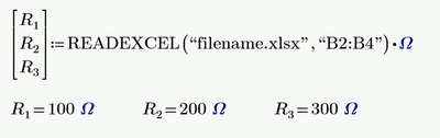

I would suggest that you read in the data via READEXCEL.
If you have the values of, for example, three resistors in cells B2 to B4, you could read all three into three variables in one go and immediately assign them the correct unit.
In this example I used literal indices, so creating three different variables. Of course you also could read in the data in just one vector whose elements you can access using vector/matrix indices. As I usually never change the value of the system variable ORIGIN from its default value zero, the first elelement is accessed with index 0
