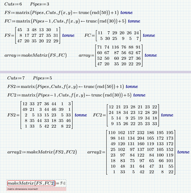

The outer pipe (pipe 0) is held. What I'm trying to achieve is a single array with number of rows matching the number of cement bonds, each row representing the total mass that each cement bond is having to hold (if we assume there's no slip between steel/cement), working inwards. The number of cuts (columns) will be the same as for the pipes/cement. So, for example:
cb0 will be the mass of cement0 + pipe1 + cement1 + pipe2
cb1 will be the mass of pipe1 + cement1 + pipe2
cb3 will be pipe2 only

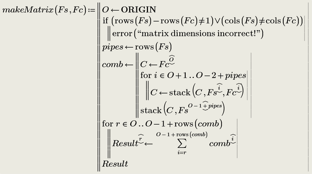

Here is a possible solution to your problem:
Prime 6 file attached

I agree with Terry that with every question you should
1) attach a worksheet with demo data, preferrably also showing which result you expect
2) say, which version of Prime you are using (still Prime 7 ?)
