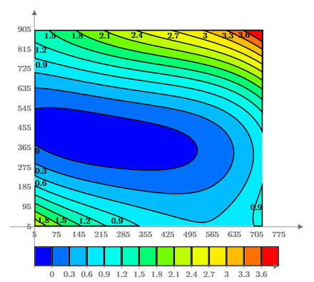

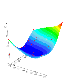

This sheet first plots a series of x,y,z data points for a floor elevation survey. surface is plotted as raw data
Then it does a surface regression analysis and generates a polynomial the poly surface is plotted.
I need to determine the curvature and then radius of curvature for any and all points.  I will use an overlay of distress to determine the radius of curvature that causes distress, I currently have a slice method of raw date and of the surface  but this is cumbersome.

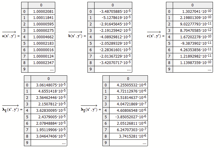

However, I think I might have spotted the cause of your unexpected nested vector of 49x1 vectors:
Vectorization only applies to the vectors it sees in the variables/explicity defined matrices.  It does not apply to the results of an expression that uses those vectorized variables.  Hence, the behaviour you see in the clip above.

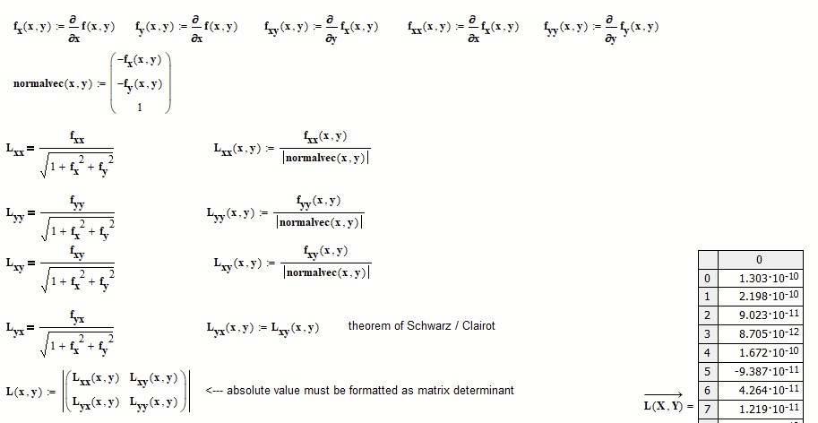

Are you sure that L.xx(1,2) should be a vector but g.xy(1,2) is just  a scalar?
I guess L.xx(1,2) should be a scalar, too. Otherwise it would be wrong to call an expression which contains L.xx using vectorization.
Its a good idea to test functions which expect scalar arguments if the result is as expected before you call them vectorized with vector arguments.
According the cross product I am a little bit confused what it should denote. As far as I know a cross product of two vectors is only defined for 3 and for 7 dimensions!

As I already had written here Re: Curvature of a surface MCAD 15 M050 - PTC Community, your normal vector should be  a function in x and y and not a constant as you tried it to define.
So you should use what you have written here
but without the equal sign at the end and with n'(x0',y0):= at the left hand side. Its a function, not a constant.
I also wonder why you call the first function argument x.0' and the second only y.0.
Looks quite strange to me, but then the name of the formal arguments of a function do not matter at all.
Being lazy I would simply use
Keep in mind that x and y here have nothing to do with the vectors defined earlier - they are just the formal function arguments.
You may equally use a and b or any other names here.
The same applies to the other functions like
I would define them without vectorization and apply vectorization only when  you call the function with vectors as arguments.
BTW, is there any reason why you named the first partial derivative of  f wrt x  x'.0 and not simply f.x ? I found the sheet much harder to read with names like that.
Furthermore I am confused about what L.xx etc, should be
You write as an explanation
which would mean that L.xx is a scalar, but when you define L.xx you additionally multiply it with vector n, which of course makes L.xx a 3x1 vector, which I guess it should not be. Especially as you later define a matrix L(x,y) with L.xx etc. as its arguments. What you define in Mathcad as L(x,y) seems to have nothng to do with the determinant of the expression shown to the left of it, nor with what is shown in the picture to the right of it as your definition uses the first derivatives and not the second ones.
I guess you misinterpreted this handwritten formula
Here X is a vector (x,y,f(x,y)^T and a second derivate (no matter wrt which variable) means you get (0, 0, f.xi,xj)). Scalar multiplication by unit vector n simply results in f.xi,xj / sqrt(....).
So it should be that way:
Similar
and then
Enjoy simple, not nested result vectors and real result for the quadratic equation
Conclusion: Once you have your function f(x,y) forget about the data vectors X, Y or x' and y' and set up your calculations as functions in simple scalar arguments x and y. Only when you need the results for your vectors call those function (vectorized) with the data vectors as their arguments.
Hope this helps!
