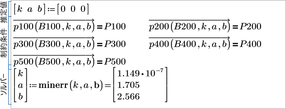

Here is an attempt to calculate just one set of parameters (a,b,k) which should fit all five curves.
The solve block used is not very sensible with respect to the guess values.
As you can see in the following plots, the fit isn't equally good for all curves. Of course you get better fits if you derive the parameters for each curve separately.
Attached sheet is in format Prime 6

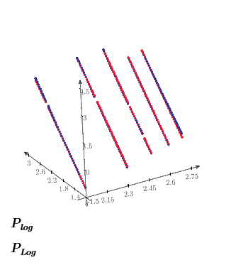

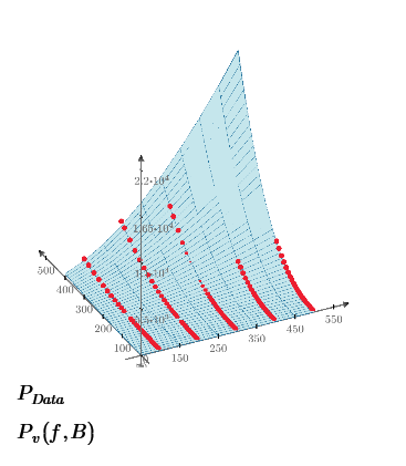

I just use Werner_E's solve block and also the one of Fred's log data to 3D plot data.

it seems like the method you use is more accurate?
(To:J_power)
Why do you think so?
For a comparison of the two fits see here: https://community.ptc.com/t5/Mathcad/Curve-fitting/m-p/895688/highlight/true#M208272

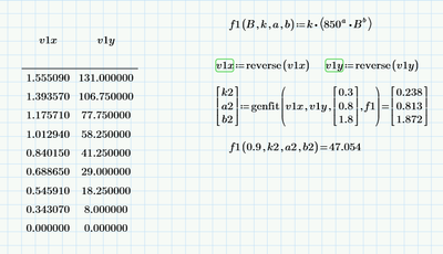

Part of the input for the 'genfit()' function are two column vectors vx and vy being the data you intend fitting to.
So my question is do you have the original data that forms the graph or are you working only on an image of the graph?
If you only have the graph you will need a program like PlotDigitize to get some x,y values.  That is what I have done here.

in your plot, you only draw 1150Hz curve in Mathcad and you use genfit to find the coefficient.
can I draw the all frequency to find the coefficient?
You need to use genfit() five times to get the coefficients.  One for each line on the curve.

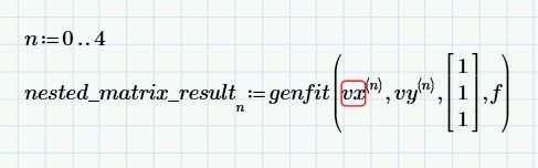

If the data was organised with vx being a matrix with each column being the B data for one line and vy being a matrix with each column being the data for one line in turn, you can use one genfit solution.  This would generate a nested matrix of k, a, b solutions.
Cheers
Do you mean I will get k,a,b coefficient for each curve or I will get total solution for five curve.h version
Yes you get five different coefficients one for each line.

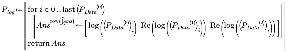

Express does not have access to "genfit."  But, by taking the logarithm of the equation we can turn it into something that least squares can deal with.  Attached is a sample in version 4.
Note that only one curve's data was used to develop the solution.  If the constants (k, a, b) are true physical parameters then the curves for other frequencies should also be correct.
By the way Fred how did you get the red area line?
Fred's log techniue
genfit with start guess of 1,1,1. You can get a different k,a,b by changing the guess values
