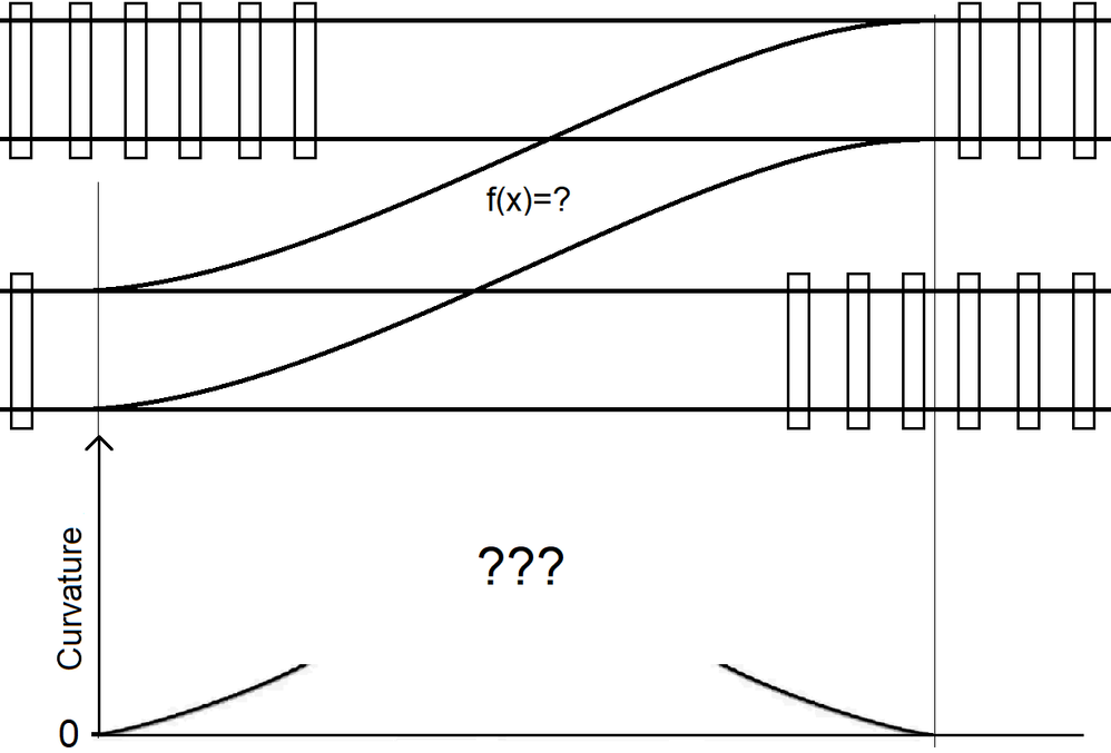

Curve for switch transition
What do you think the curve should be f(x).

I would treat it like a cam, One key feature would be to avoid infinite jerk (rate of change of acceleration).  I've read that that makes for a more pleasant experience for the passengers (or cargo).  There are many cam profiles that can do that.  You'd want to balance jerk, acceleration and sideways velocity.  I'd start with 3-4-5 poly or cycloidal cam profiles, but I like to think the industry standardized on one.

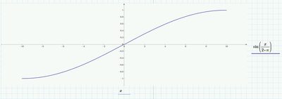

Your sketch of the track's transition (zero slope at each end) looks like a simple sine wave to me!
Cheers!
Cheers!

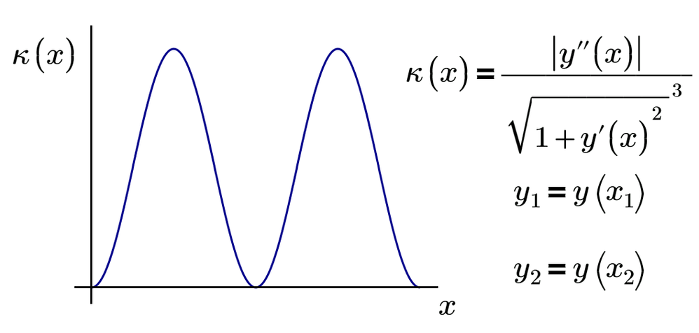

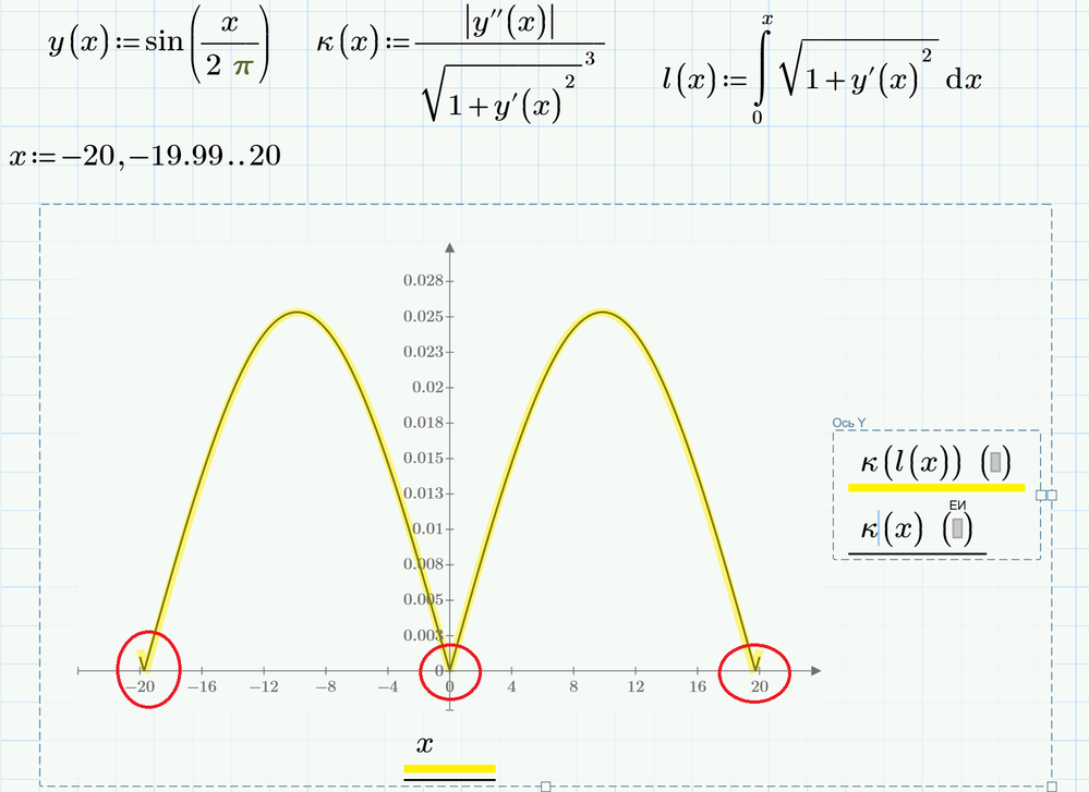

What can you say about this solution?
I specify the type of curvature of the curve (sine for example) and numerically solve a second-order differential equation - a boundary problem:
Paying attention not only to curvature but also to the third derivative of the displacement ("jerk") is certainly not unimportant, but let's not forget the fourth derivative ("snap" or "jounce"), the fifth derivative ("crackle") and the sixth ("pop"). 😄
The requirements for railroad tracks with lateral acceleration, wheel-rail friction, etc. are certainly completely different from those for road construction, where you could perhaps model with one (or two congruent) clothoid(s).
By the way, you're not just dealing with a single function here! If f(x) describes the fictitious center line, then the rails are so-called parallel curves and these are usually more complex different functions.
If you take this problem seriously, you can certainly have a lot of "fun" with it for a very long time ...
