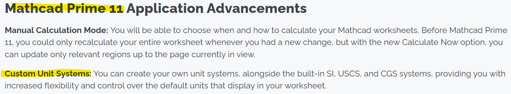

Isn't 'Custom Units' implemented in Prime 11?

You (and Cornel) seem to be right that its already implemented in P11. Have not yet installed P11 and there seems to be no comprehensive "Whats new in P11" documentation online (or I hadn't looked hard enough for it).

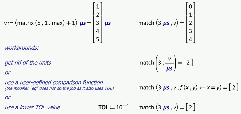

I guess that its for display purposes only and will not affect internal calculations!? That means that with  very large or very tiny magnitudes we will still see the problematic behaviour with "match" and "lookup" and maybe also when solving bad conditioned systems of equations?
EDIT: Incidentally, this is what I was referring to with the problematic behavior of “match”, etc.:
Is the effect the same in P11 when the custom time unit is set to microseconds?

Me neither, I don't have yet Prime 11 installed (since my company hasn't made this latest version available yet, but they should introduce it in a few weeks, most probable I am expecting, and then I can see how Prime 11 is working, i.e. how the 'improvements' of this version feel...(though I don't expect it to be something special or too much powerfull))
Official what's new documentation: https://support.ptc.com/help/mathcad/r11.0/en/#page/PTC_Mathcad_Help/whatsNewMathcadPrime.html

Thanks, I know about the workarounds by either getting rid of the units as you did or by setting a lower TOL value or by using your own comparison function:
Getting rid of the units also can be a bit tricky and error-prone if you think of "vlookup" or "lookup", where the results are expected in the correct unit.
However, I would have been interested to know whether it works in P11 without these tricks if you use a custom unit system with microseconds as its default time unit.
Do you use Prime 11 and does your answer mean that nonetheless its still necessary to use workarounds??
