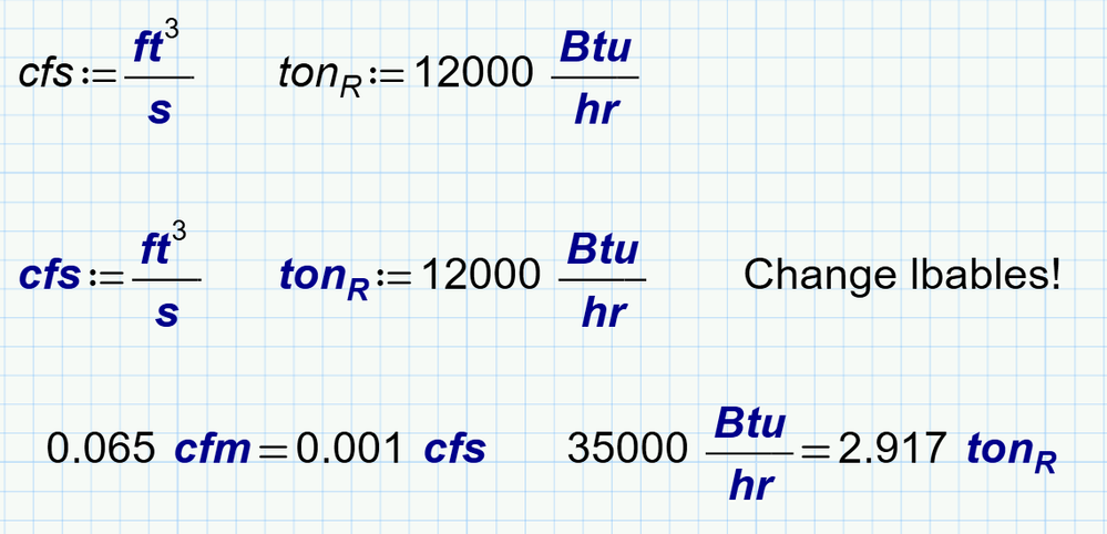

I'm trying to define custom units in Mathcad Prime 6.0, but for some reason I don't seem to be able to. I define the unit as a variable and then try to change the label to "Unit", but Mathcad doesn't keep the change.
I used to do this in previous versions within a nanosecond, now it doesn't seem to be working, so I'm wondering if this is a bug in the software or I'm missing something...

Here's a file with a few examples. I cannot get the label to change from "variable" to "unit" no matter how hard I try.

Not clear what exactly you tried.
You have to label the new unit as unit when you define it, nor only when you use it.
I attach the file with the "variables" changed correctly to units.

It looks like there is something messed up with my Mathcad Prime. If I use the file you attached, just like you, I can change the label from "variable" to "unit". However, if I open, say, a new worksheet and try to define the custom unit, it doesn't let me change the label for some reason.

Even if the advice is trite and cheap -  I would consider a new re-installation of Prime.
