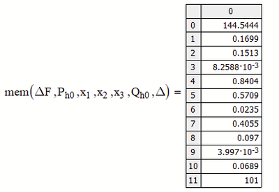

Good day to all forum visitors!
Tried to apply IF statement inside the cycle to change condition variable WHITE, but encountered error - Unitless (Mathcad 15). Rummaged through forum and mathcad literature, could not find anything(
Who can give advice?
Thank you in advance!
(To:Motixa)
When calling "mem" you forgot to add Delta as its last argument:
2 REPLIES 2
(To:Motixa)
ttokoro
(To:Motixa)
Just add Δ for second mem.
