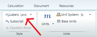

That <ctl-u> part was what I was missing: I was trying to do it through the tool bar which does something else.
"I was trying to do it through the tool bar which does something else."
Which part of 'the tool bar'?
What [Ctrl-U]  does is toggle between labels, specifically between the current label and 'Unit', and from then on between 'Unit' and 'Variable'. You can accomplish the same by using the menu bar:
Note that this is something completely different from inserting a unit (from the predefined list of units), which can be accessed on the ribbon to the right of the box with labels.
