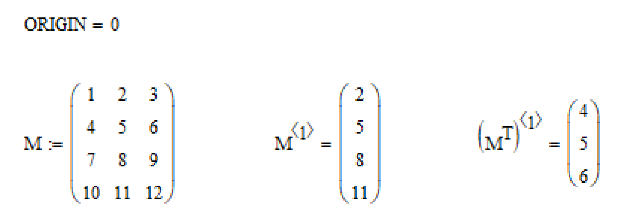

Your maxrows2 will always return the last column of the input matrix.
Here is a solution which automatically will deal with any number of rows. As Mathcad 15 does not provide a row selector, we have to transpose the matrix and use the column selector.

Although, if you wouldn't mind explaining, what does the <c> operator do in M^<c>?
Many thanks and kind regards
(To:AATaylor)
the <c> operator is the column selector which I mentioned. You get it by typing Ctrl 6 or via the matric palette.
It returns the column number c, a column vector. So this column vector is fed into the max functions which returns the max number of that vector.
Mathcad 15 an below don't offer a row selector (Prime does - one of the few improvements in Prime) and thats the reason I had to transpose the matrix first.
