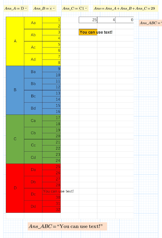

I have three materials. Each with their own sub types
Material - Type
A             - A1, A2, A3, A4
B             - B1, B2, B3, B4
C             - C1, C2
My idea is to let the user to select the material and type. I was thinking on having a combo box to select a material and then a second combo box that would change depending on the material selected.
I have been trying for quite a bit without luck. Maybe there is an alternative way of doing this? Any help is appreciated!

Combo box with EXCEL can select what you want from EXCEL sheet data in Mathcad. Prime 8 sheet attached.

I recommend upgrading to Prime 8 for slightly better capabilities in combo boxes.
Did you know you can add columns to your combo box? Doing so creates a vector of data in the same order.
