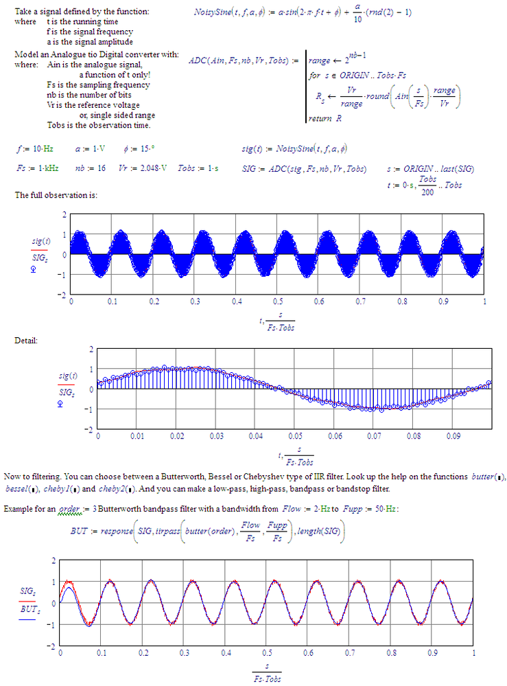

Something like:
-MFra-
(To:NeedToKnow)
The front end of a real DSP must be made up of a low pass filter, for example a Butterworth LP of the fourth order, followed by the sample and hold system and then by the ADC. The sampling rate must comply with the Shannon sampling theorem (don't  take a sample rate at your leisure).
