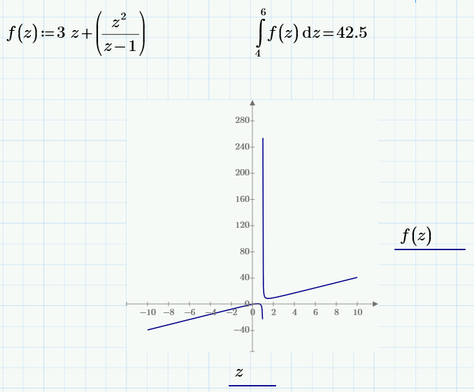

If you only need an answer at the end, maybe the integration operator (Ctrl + Shift + I ) will do:
LucMeekes
(To:twolowiec)
I think it depends on how 'nasty' your integrals are, and where the integration limits lie with respect to the nasty parts of the integrand or integral.
Please provide an example.
