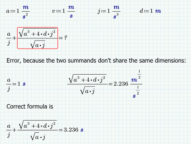

There's a problem in your middle equation for time! (One of the reasons I use Mathcad is because of the units; when units don't balance there's a problem that needs to be investigated!)
See attached!

Concerning the unit mismatch which Fred noted, the error in formula (5) in the screenshot you posted here
https://community.ptc.com/t5/Mathcad/Distance-between-floors-matrix/m-p/814280/highlight/true#M202215
is now quite obvious - especially if you look at formula (8) in the pdf you just posted.
In formula (5) mentioned above is should read
Note that the last "j" in the denominator is NOT under the root!

As he already wrote its one of the major benefits of Mathcad and Prime that it can naturally deal with units and will choke on formulas which are not unit balanced.
So its normally a good idea to add the correct units. You can run into problems doing so if the formulas you use are empirical formulas meant to be used without units - you would have to use them unitless in Prime as well.
Here is an example where you can see that Prime flags the unit error in case the wrong formula is used (but Fred already had shown something similar in his posting):
