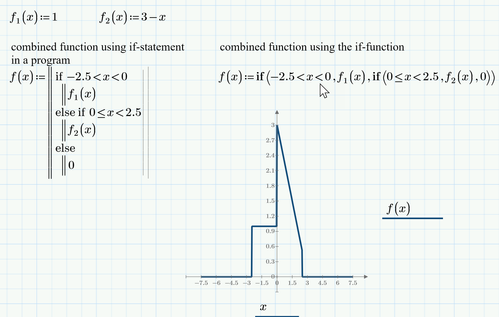

Our issue is that some of our Mathcad Prime sheets stops being able to calculate – especially when we are using the program for calculating Fourierseries/-integrals. The documents work just fine when we enter the calculations at first, but when closed and reopened it does not work anymore.
We have tried different settings in the “calculate” menu, but we haven’t been able to fix the problem.
I have linked to a document, that won’t calculate anymore.
Thank you in advantage.

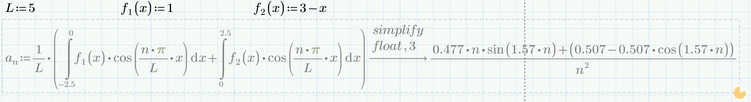

I tried in P4 and P5 and the first symbolic calculation of a.n did not stop - yellow dot forever.
Curious effect: When I tried to add "assume, n=integer" I got an error as of wrong syntax of the assume modifier.
(To:Annesofieoe)
What exactly do you mean with "won’t calculate anymore." ?
When I open your sheet and try to recalculate it it starts calculating but the first symbolic evaluation (calculation of a.n) seems to run forever. In fact its still calculating while I write these lines.

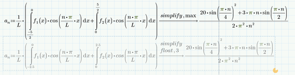

Another observation:
I retyped the expression myself in front of the problematic region, stopped and restarted calculation and the region evaluated correctly. I had just used 5/2 instead of 2.5 to avoid the symbolics switching in float mode.
I copied that region (the one I just typed myself) and changed the 5/2 to 2.5 and now this newly typed region would again refuse to finish calculation.
Still no idea whats going on here and why the symbolic float mode seems to be damaged in this file.
I have not tried but I guess when I start a perfectly new sheet and type the definitions of L, f.1, f.2 and a.n it would work OK, even with 2.5 instead of 5/2.
EDIT: It seems definitely to have to do with the float mode. When I add "float,3" in my (as far working) first region, it does not finish calculating after a recalc attempt.

So I am out of ideas as to what the reason for this effect could be and why the problem did not show up much earlier here in the forum - just one crude workaround I stepped over by chance:
When the calculation of a.n runs endless, stop all calculations, delete the modifier "float,3", start auto-calc. The calculation should work now. Then you can again add the "float, 3" modifier and the region still evaluated flawless.
Guess you will have to do that with every single problem region 😞
You may consider avoiding float mode by NOT using "float" and NOT using the decimal point (but rather use exact fractions). This seems to avoid this strange effect and will give you better results in many cases.
And if you add "assume, n=integer" as modifier, expressions like sin(n*pi) will correctly simplify to 0, etc.
Not sure if you know, that the "float" modifier does not only affect the display of the result but also the precision of the whole calculation. Thats the reason this modifier should used rather sparingly and with special care anyway.
