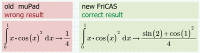

If you are talking about the new symbolic engine in Prime 6, I expect that some of the typical errors of MuPad (mainly when it comes to integration) don't show up in  FriCAS (would be surprising if they did). The last one reported her was this:
But we sure will see new errors in symbolic calculations using the new engine and some already have appeared. Its too soon for a judgment, but based on what @ttokoro and I have shown in this thread
https://community.ptc.com/t5/PTC-Mathcad/Mathcad-Prime-6-0-Symbolic-Engine-based-on-Axiom-Fricas/m-p/629561/highlight/true#M187326
it looks like at the moment we are better off using the old symbolics. We will see if those bugs get fixed in a coming maintenance release of Prime 6 (there weren't any for P5) or at least in Prime 7. But based on the experience with PTCs development of Prime in the last 10+ years, I have only a very weak hope that we will see a quick improvement here.
