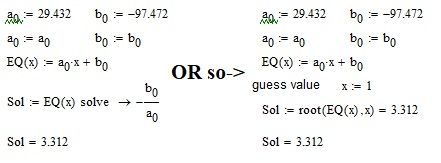

Hi.  I am doing a pretty simple calculation and I expect x = 3.3117 but 'solve' would not return the value.
I am inserting an additional line to calculate x manually in the middle of a design MathCad sheet but it is painful.
Why couldn't MathCad perform that simple numerical calculation but only repeat it symbolically?  Any help would be appreciated.

Do it this way:
Though why you think this is less painful than simply setting x:=97.472/29.432 is beyond me!

Sorry.  Your suggestion is not working in MathCad 14.  ㅠㅠ

The calculation proceeds as follows:
pyoyoon
(To:-MFra-)
Thank you!  This is working in MathCad 14.

1. You should ALWAYS attach your worksheet, or at least A worksheet that conains the problem. That helps tremendously!
2. You get this weird result most probably because, instead of using the symbolic operators pad, you typed 'solve, x' immediately after 'EQ(x)', which caused a multiplication like
EQ(x)*solve,x
Then you pressed the button for a symbolic evaluation. That results in the answer you get.
Correct this situation (by all means USE THE SYMBOLIC PAD to initiate symbolic operations) and you'll see that it works like you expect it to.

Have you also read Lucs #2) ?
It looks like he found the problem of your expression giving no result.
After all your approach should work as well as Alan's small variation if you use the "solve" from the symbolic palette or at least type Ctrl-Shift-. to get the symbolic arrow with a placeholder and then type "solve,x" there.
