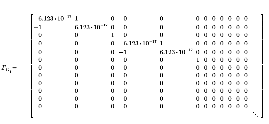

Dear all
I try to divide element matrices but when I use n=100 , program error.
Do have any methods/solution to avoid this problem?

The first one is 6*6, however, the others are 3003*3003, that all data=0 except the 1,1 to 6,6.
Therefore, if you use only 1,1 to 6,6 data only, memory error may disappear.

Have calculated the worksheet while at the same time used task manager to keep track of the memory used. It works on my machine but I am running 128GB of Ram and 32 cores for music production and video editing. The worksheet uses at peak around 114 GB and after calculation around 92 GB. So it works on my machine (just).
Your method of assembly looks to be create 1000 global stiffness sized matrices of zeroes with a small area 6 by 6 with the element transformed stiffness matrix inserted and then you sum them. This is very memory intensive and there is a better way. You need to keep only one global stiffness matrix, and the required number of elemental transformed stiffness matrices and assemble global by using indices that reflect the connectivity of the structure. Far less memory is needed.

OK worked on the original posting worksheet.
Made two changes to the calculation of KG that only keeps one global stiffness matrix.
One the calculation of the PutElements function so the elemental matrix data is added to the one global matrix
Two the definition and calculation of KG itself
The worksheet peaks at 2.1 GB and finishes at 1.4GB of memory. Suitable for most machines.
What is needed still is the calculation of Γ but I will leave that to you now you know how to save excessive memory.

There is one more obvious candidate for saving some memory. Like everything it is the law of diminishing returns. The first saved heaps of memory 122 GB down to 2.1 GB when nmesh = 100, but the second obvious candidate will not save as much as this.
A regular structure is being examined with only two or three unique element transformed stiffness. A pile element always the same length and an earth element always the same length (but different orientation each side of the pile)? Current problem definition uses 1000 x [6 x 6] to store same non transformed element stiffness and 1000 x [6 x 6] for same transformation matrices to represent these two/three types. This could be compressed to 2 or 3 x [6 x 6] transformed element stiffness in a two or three element single column vector of nested matrix, plus another 1000 x 1 column vector that indicates which of the two/three types to use for the particular element in question. Some recoding would be required.

The worksheet is getting what looks like errors. I have looked at it closely and the low elastic modulus for soil is applied to the concrete "column", and the high elastic modulus of the concrete is applied to the soil "beam". They need to be swapped as in the screenshot below in red.
For consistent units you need to use MPa not GPa so the value of E for concrete (col) and soil (beam) need to be adjusted as below in red.
These two are the reason the result is as shown in your earlier posting
