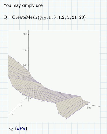

Simply use  Q:=CreateMesh(q3D,1,3,1.2,5,21,20) to get the same result.

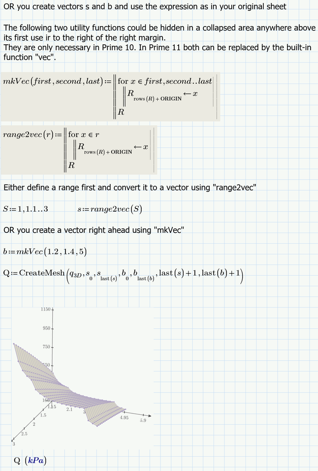

If you really need to convert the ranges S and B to vectors s and b you may use the small utility function range2vec which was posted here in the forum a couple of time. Starting with version 11 of Prime you should rather use the new built-in function "vec".
See for example Re: This value must be a vector in MPC10
Here in more detail:
Prime 10 sheet attached
It is the old range is not a vector and visa-versa issue.
si and bi are index ranges, s and b are vectors.
